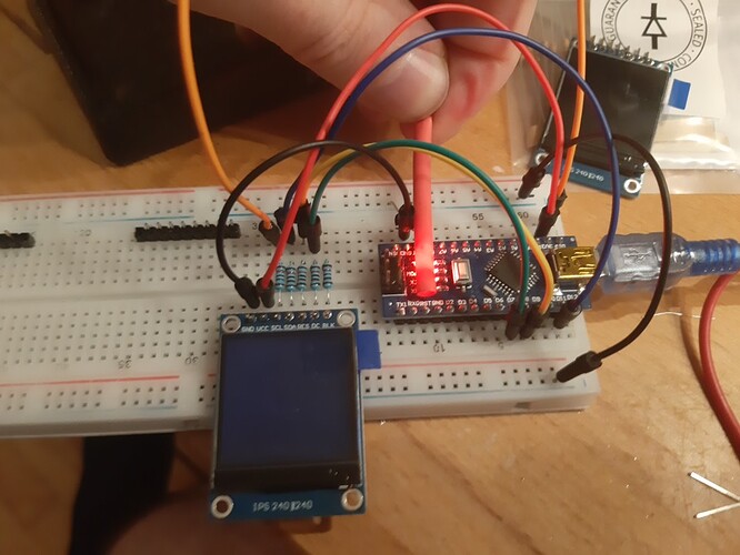

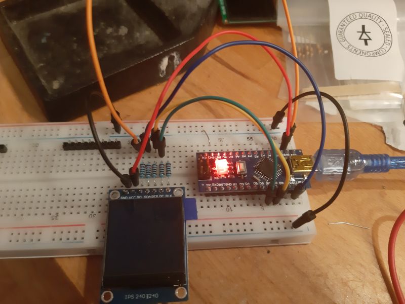

I have the IPS 240*240 also, ordered through Aliexpress
Im using the exact library as linked above, and the included hello world sketch.
I have tried Pins 7 and 8 as in the code, 8 and 9 as in other ST77XX drivers.....but all i am getting is a black screen. Backlight is on if i look at the shield from the side.
Nothing else is happening.....
Here is my wiring:
Try connecting the GND pin on the display to the GND pin on your Arduino.
You have connected VCC pin to 3.3V.

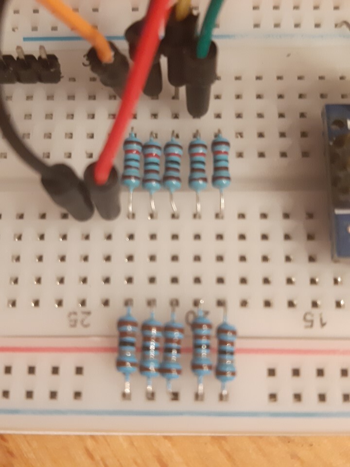

We can't read the value(s) of your series resistors.
You can leave BLK open. But it is safer to use a known logic level.
Seriously. Life is much simpler with proper 3.3V GPIO.
David.
The GND is connected to Arduino GND via the black cable to the GND Bus, and from there with the silver bridge.
Connecting directly does not change the result, see here:
Here are the Resistors. They are 1.2K and 1.8K
Go on. Look at your black wires. What is a silver bridge? Ah-ha. 163720.jpg shows a wire jumper.
So your wiring should work.

Yes the wiring works...it works halfways on the other display, so connections seem to be there and correct so far. Also the voltage divider on 1.2K and 1.8K puts out something in the usable vicinity (2.8V).
What i find irritating is that the backlight is on, but the screen turns all black......i would expect it to show white if not connected or adressed properly.....

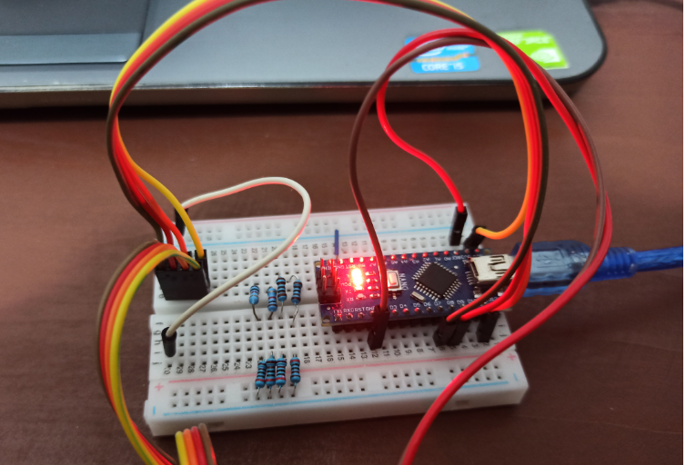

Yo tenia el mismo problema quería conectar mi Arduino Nano con el display ST7789, Tengo que admitir que lo compre Chino, e intente varios circuito sin poder solucionar mi problema al realizar mi circuito mi display solo mostraba pantalla negra, hasta que encontré la solución, resulta que tuve que guiarme de este video:
allí te dan una librería que yo la estoy utilizando y me va de maravilla, solo deje de utilizar el Pin 9 y 8, los sustituí por 8-RES y 7-DC. Realice la prueba y listo funciona en mi caso no utilizo resistencia, con el arduino Uno si tengo que utilizar te dejo el orden de los pines.
#01 GND -> GND
#02 VCC -> VCC (3.3V only!)
#03 SCL -> D13/SCK
#04 SDA -> D11/MOSI
#05 RES -> D8 or any digital
#06 DC -> D7 or any digital
#07 BLK -> NC
Mi arruino es Arduino nano Atmega 328p smd versión clone. :PAGS :PAGS :PAGS
Espero te funcione no soy experto pero me fascina aprender nuevas cosas y contribuir.
dejo evidencia.
Ignora las resistencias y el cable blanco se me olvido retirar, cuando retire la tarjeta arduino uno.
