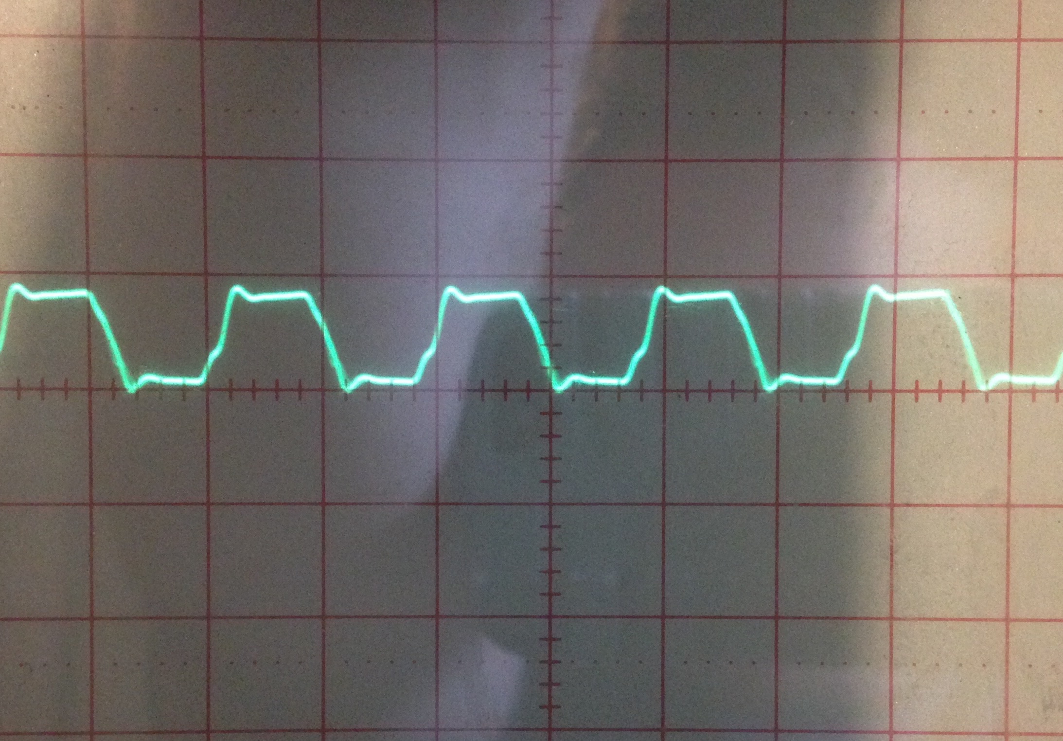

So, I'm working on a project at the moment. One which requires a clock source, and I've been looking at a LOT of schematics. There really does seem to be a different circuit for every frequency of crystal, and even between manufacturers I've been able to tell a difference in performance. But most seem to be pretty close, and I can only assume that this is a result of varying load capacities of different crystals.
And this brings me to the subject at hand, frequency vs duty cycle. I had originally been trying to use a circuit like this:
This seemed as if I just could not make it work, and if it did work, it was VERY erratic. What I mean by that, is that the crystal seem as though it wouldn't oscillate, then it would but at a super high frequency (2-3 times the one listed), then it would slow down, then speed up, etc. All this was tested with my logic analyzer in case you were wondering. Although it seem that this variation on the circuit is quite popular, I just couldn't manage to make it work.
Then I managed to find a PDF document on the net which was pertaining to clock circuits, and found example 1d on page 2 to be very similar yet different. It had different values for the resistors, which do not seem to be too critical in value. And had done away with the third gate, and the 120pF cap. The pdf is here:
Circuit Techniques for Clock Sources
When I breadboarded this circuit with a 1k and 500k resistor and a 1nF cap, the circuit works great. I get a steady 3mHz squarewave, and all seems good. Except for one thing, the duty cycle. Now in theory, the duty cycle should basically be 50%. And I get that about 2/3 of the time. However, the other 1/3 of the time it is about 62.5%. Now, I don't think this is going to be too big of an issue, if any, considering I'm going to be using this as a clock source for a z80 build. But I cant help but think it might be a problem for any peripherals that I might hook up, read DRAM.
to further complicate the matter, I've noticed that when I use a crystal of a higher frequency I continulally get erratic oscillation, I'm sure as a result of the cap. But this makes be ask three questions:
  1. Is the duty cycle of the oscillator of any concern to the maker?
  2. And if so, what changes can be made to make this, or another, circuit more reliable?
  3. Do you have a preferred circuit for crystals in the 3-20mHz range when building clock sources?
Just for giggles, in case anyone wants to see the data pulled from the analyzer, it is attached.

I think that your perceived 'problem', is due to the limitations of your test equipment.
Your logic analyser, is sampling a waveform that is roughly sinusoidal, and converting it to a square/rectangular waveform.
The sampling frequency of 24MHz is only 8 times the oscillator frequency.
If the waveform that you are viewing is high for 4 of the logic analyser's clock periods, and then low for 4 clock periods, it will indicate a duty cycle of 50%.
However if the logic analyser 'sees' the signal as being high for 5 clock cycles and low for 3 clock cycles, it will indicate 62.5% duty cycle.
For an input frequency of 3MHz, your analyser can only indicate certain quantised values for the duty cycle.

John, now THAT makes sense. It's a cheap analyzer. I think it was $10 or so. And it obviously has it's limitations. Sticking this on better equipment would be more insightful. However, being a hobbiest, it's not really in the budget. At least not yet. I've got a buddy who is an aviation technician. I need to go drink a few cold ones with him, so I might see if while we're doing so if he'll kindly test it for me. Because if what you're suggesting is true, it very well might be a very consistent clock.

Realizing I had a serious limitation with my test equipment I decided to go on the search for an O-scope. I found a exceptional deal on an old analog BK Precision 2120. Got it delivered for less than the shipping price of many models.
After some testing the circuit that I was attempting to use (both the 3 inverter and the 2 inverter variants) I decided that this circuit will likely not serve as reliable. And attempts to use it (bear in mind, on a breadboard) proved unreliable.
The attachments below show the results of the wave. The first is of a 3 inverter circuit. The second of the circuit with only two inverters. Retesting showed high level of consistency.
The jury is in, and it appears that the variant with two inverters is superior in function to the former. However, nowhere near a square wave. And as such, would likely not function as a clock source for older CMOS devices.
I plan on proceeding with testing of a pierce style oscillator circuit, and will post the results when I have my conclusions.
Now keep in mind that, at least per my reading, these results would vary with a differently selection of components. The 74HCT04 may by itself be a problem. Parts were from China, and may not be genuine.
Well, another interesting night on the bench. I used the scope on a DIP-14 oscillator to begin with. The frequency of this particular unit is 6mhz. Turns out, clock oscillators don't make a square wave as I expected. At least not this one (MCO-1510A). The first picture attached is of this unit. Once again, very similar to the above circuits. Considering this is intended to run a Z80 processor, in a larger project including an arduino or clone, the square wave really needs to be just that, square.
The images below are scaled at 10x at .5uS. Voltage divisions are set to 5v.
The second photo is of the oscillator through two inverters. Very little difference was seen between using two or three inverters. Read: barely noticeable. As you can see, quite a bit of overshoot is apparent in this example.
The third picture is of the example given on the Z80.info site listed from the OP, using a 3mhz crystal, and three inverters (this time 74AS04D). As you can see, simply switching to the AS variant made a huge difference. Although, there is way too much overshoot on the slope. When using only two inverters the circuit performs the same, however the overshoot almost doubles, registering almost -5v on the oscilloscope. Still trying to work that one out in my head.
