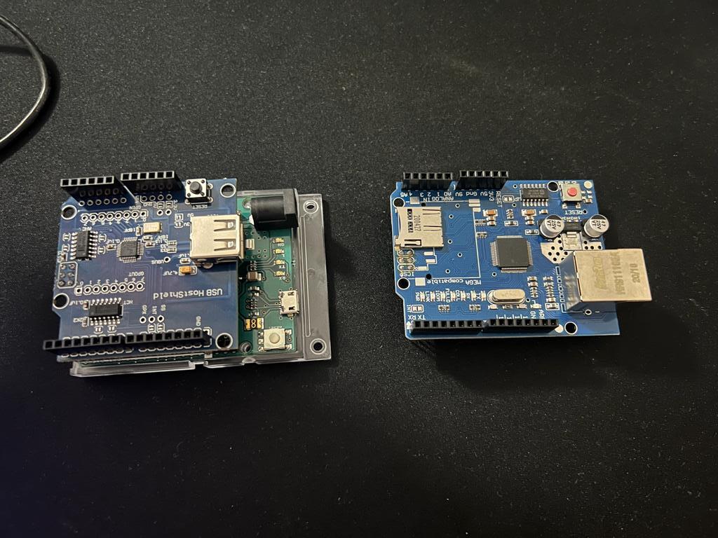

So I want to stack these 2 shields with 1 Arduino Leonardo, Leonardo is powered with 12V adapter and connected to Windows PC via USB.
  • Usb Host Shield
  • Ethernet Shield (Wiznet W5100)
Any suggestions, I'm new to Arduino and would like to learn my mistakes. (Ethernet shield's pins is not bend it looks like that because of my camera :stuck_out_tongue: )
Powering an Arduino thruogh Vin or the power jack with 12V is ill advised. Connect your 12V to a 5V DC-DC converter (buck converter) and connect the 5V to the 5V pin.
List the pins used by each shield and for what the pin are used to look for conflicts.
first you have to plug in the Ethernet shield, because the SPI lines for the Ethernet shield come from the 6pin ISP header.
I'll get a converter tomorrow asap, I'll use my USB shield to power my mouse while researching about this topic I saw some people that suggested using 12V power jack because high consuption by mouse.
About the other question, both shields bottom part looks same here is the photo. (Thanks for fast response <3 )
There is SPI lines from USB Host Shield too afaik (I might be wrong about this but both of the shields bottom part look identical).
Disassembled for a more clear picture of how shields look like.
If powering the Leonardo with 12 volt to Vin because the mouse needs current is a direct disaster. If You're lucky the controller board will shut down due to overheat. If unlucky, there might be smoke coming.
I already switched to only micro-USB power and I'll get 5V converter for adapter, still open for ideas about how to daisy chain shields.
Answered by @groundFungus in post #2:
Basically make sure that the shields don't have pins in common besides 5V, Vin and GND. Unfortunately the poor documentation of most shields can make this a hit or miss proposition.
Pins like SPI pins (SCK, MOS, MISO) and I2C pins (SDA, SCL) can be shared by SPI or I2C devices. Chip select pins, RX, TX pins, for instance, cannot. There must be a chip select for each SPI device. Serial ports can't, grnerally, be shared. So you need to know what each pin is used for in order to avoid pin usage conflicts.

Cover the top of the USB port on the USB host shield with tape(Ideally electrical tape.....) so it does NOT touch the bottom of the. Ethernet shield.
