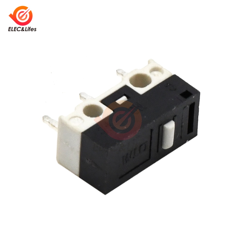

Plain old microswitches would be the most durable and simple to wire.
I considered this, but I couldn't find microswitches specifically for stepping on. The stair would need to flex just right and somehow allow the switch to return to the up position. I don't have high confidence that it would be reliable.

Does it? A microswitch requires movement, it has to be pressed down and won't trigger again until it moves back up. With FSRs or load cells no movement is necessary and they cannot get stuck on.
