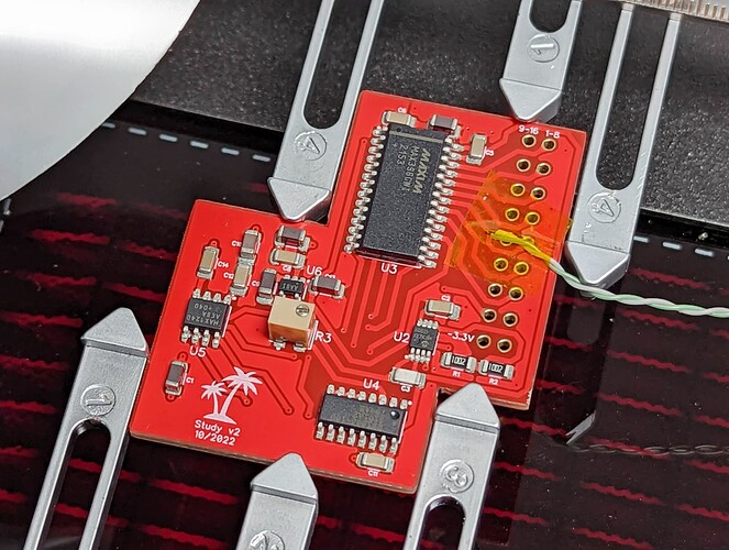

First, I can make a proper schematic now!
I improved the design slightly since the protoboard by replacing a 100K resistor with a 200K trimmer. This resistance controls the sensitivity of the sensors, ie how quickly they reach the max range of the ADC. The trimmer gives fixed resistance that's the same for all 16 stairs. I also have 200K from a digital potentiometer, so that can differ per stair, if needed. My total range is ~1K to ~400K. Testing shows ~200K works well to detect a person stepping on a stair, but we'll see in the actual installation.
Onward to building my new, fancy solution:

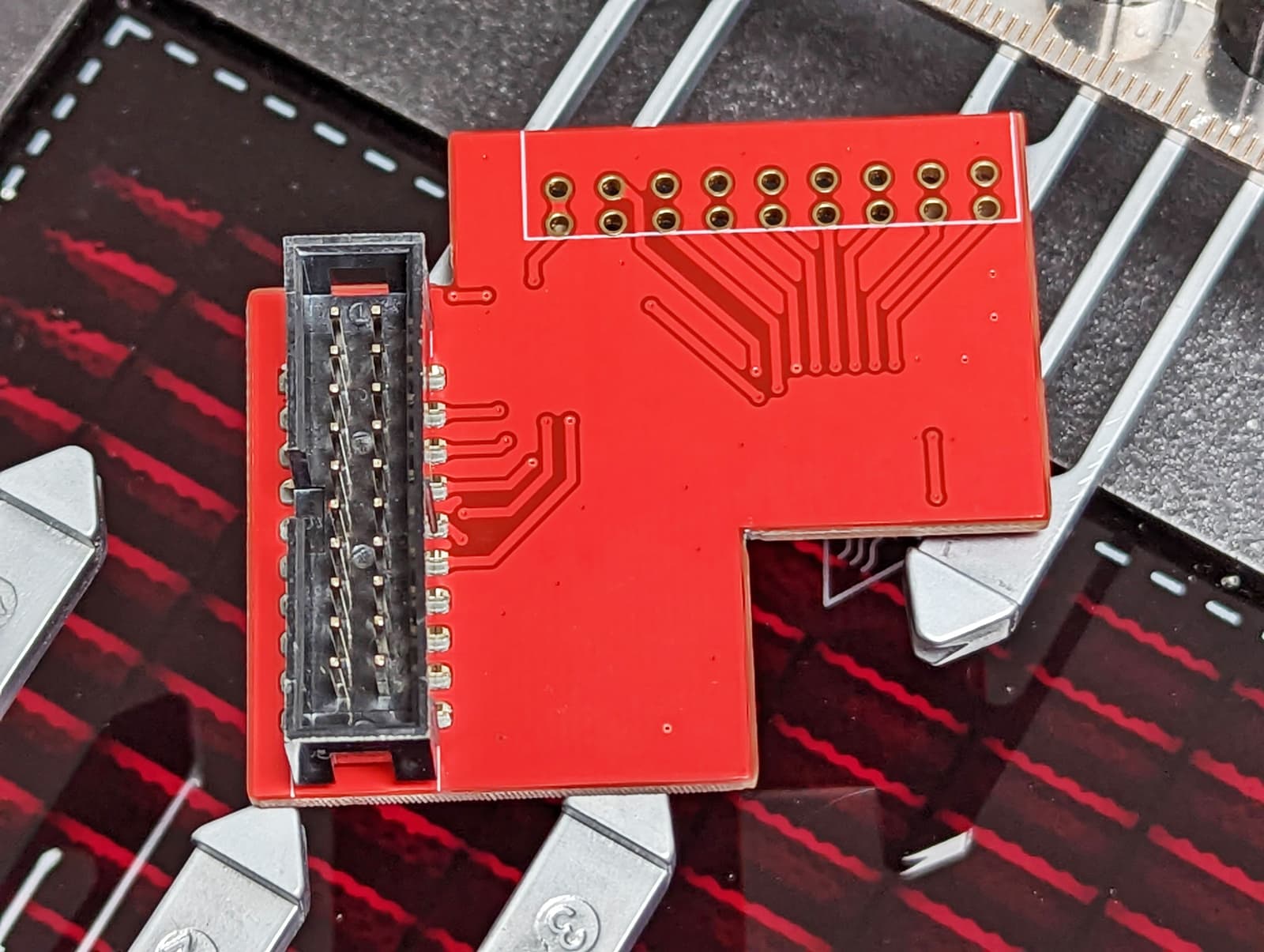

And the back:

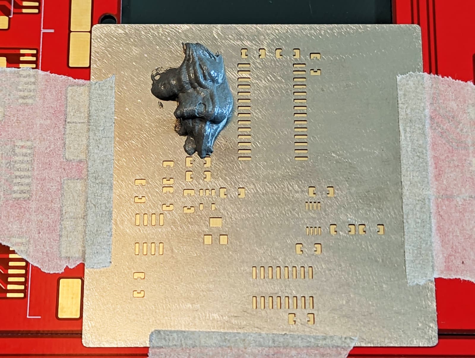

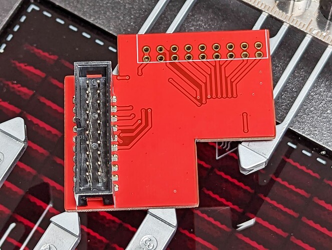

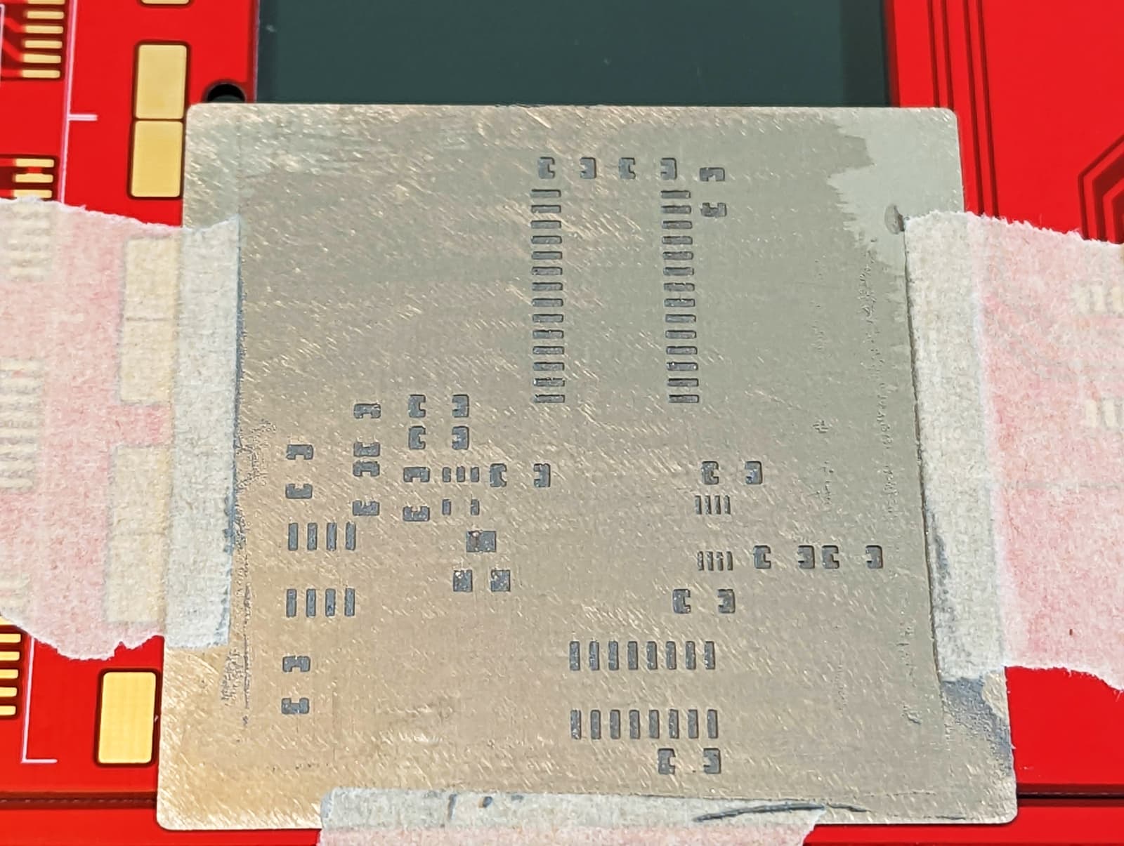

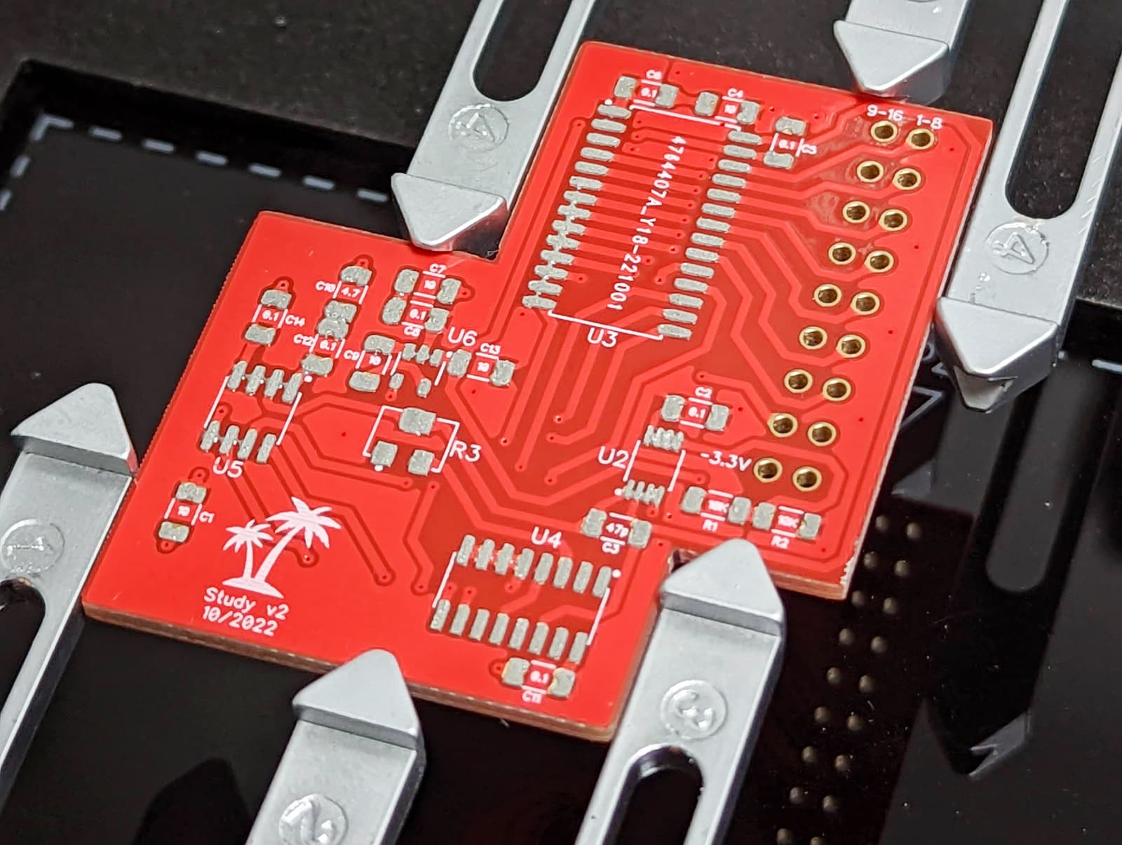

I tried to learn KiCAD, but I just don't like it. Eventually I found DipTrace. While it has its quirks, I'm much more productive with that. I came back later and tried KiCAD again, but I find there are many minor UI annoyances and I didn't find it easy to create my own footprints, so I'll stick with DipTrace.

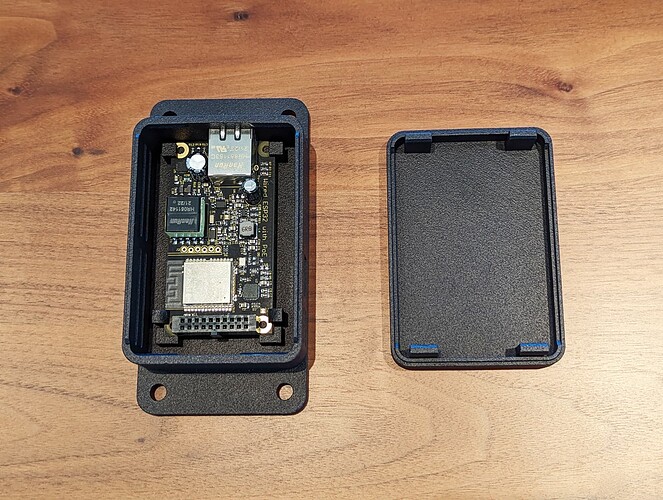

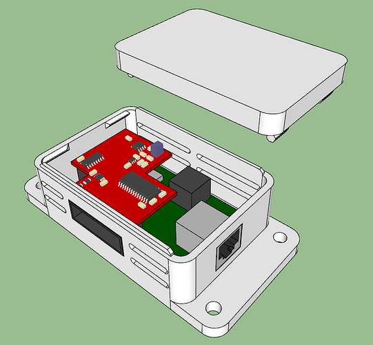

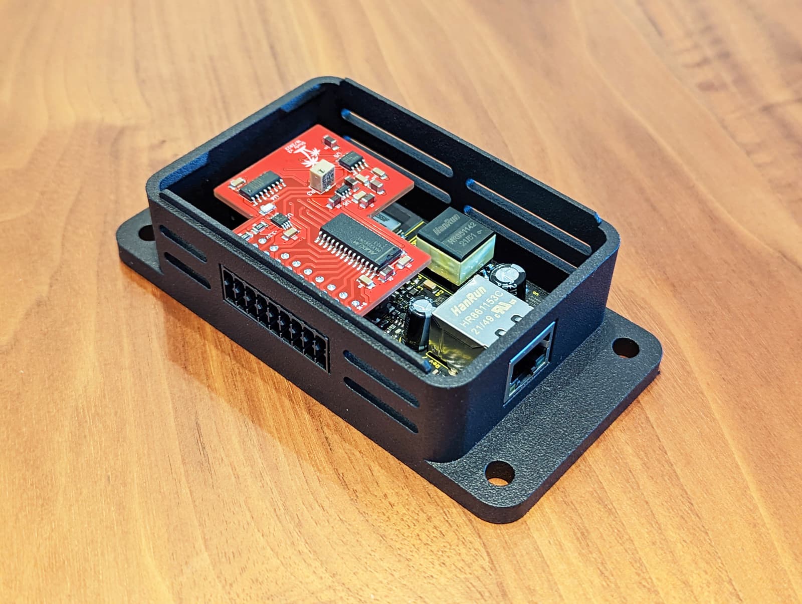

Next I needed a box for my wESP32 and PCB, so I designed one in SketchUp and got it printed by JLCPCB (who also made the PCB):
The 3D print is MJF with PA12-HP nylon. The cost was ~$35 for the box, plus shipping. Not cheap, but it is really nice, with a light texture. It's difficult to even tell it's 3D printed. One downside is MJF sometimes has light streaks on large flat surfaces. Thankfully this was never a problem for my prints. It was very helpful for designing my enclosure to use DipTrace to export a 3D model of the PCB. It's great to be able to just snap the wESP32 into the box, plug in the PCB, snap on the lid, and it's done! No wires, no screws. Maybe the best part is if I need to redesign or otherwise replace the PCB or wESP32, I just order a new one and swap it out. This pic shows the wESP32 clips:
The top clips are fixed, the bottom ones are flexible. The lid also snaps on/off, that worked out great, with no play.

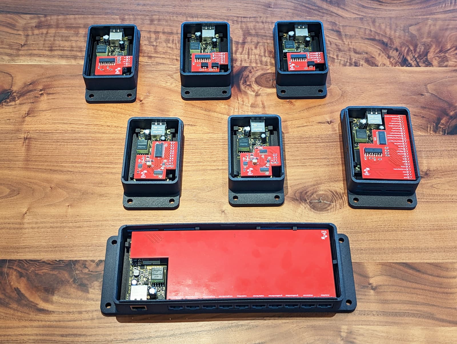

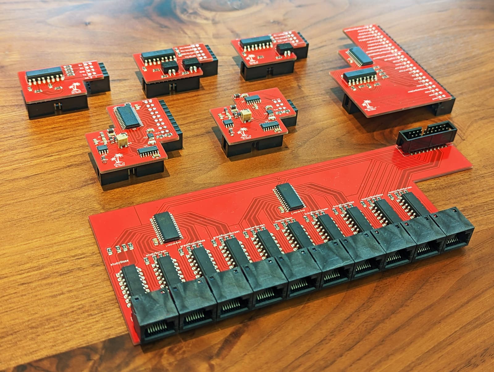

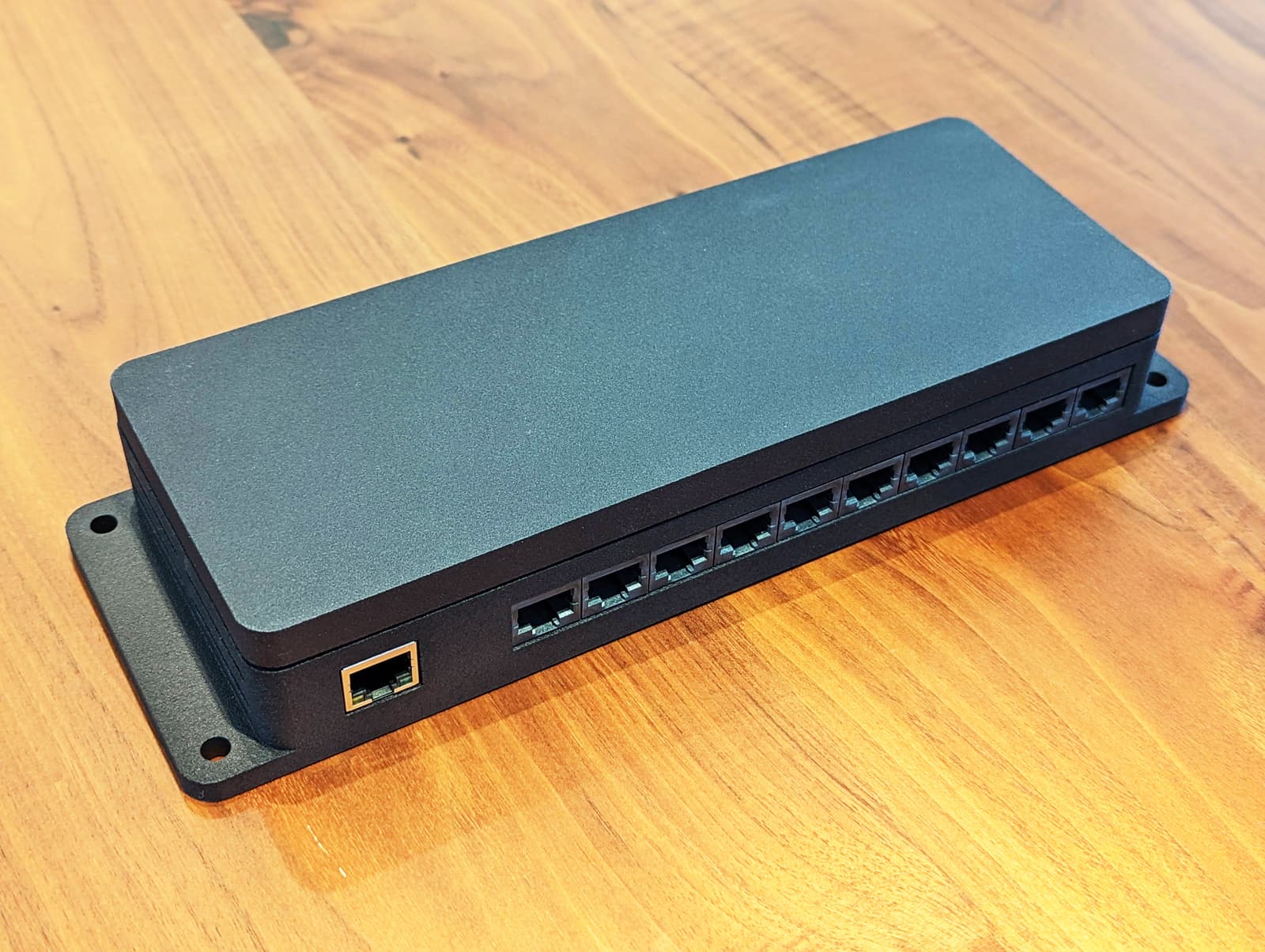

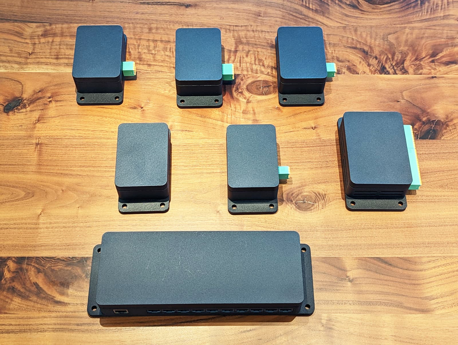

I've also made a number of other boxes for various home automation tasks:
Those control:
  • 10 motorized sliding doors (open/close/stop/lock via 40 optocouplers)
  • 6 HVAC air handlers (via Swicago with optocouplers for UART isolation)
  • 21 reed door switches (to know when doors are open)
  • Garage door (open/close via SSR)
  • 2 exterior PIN pads (for keyless entry when Unifi Access Hub closes contacts)
  • 2 door motorized door locks (via SSRs)
  • 4 more Tekscan pressure sensors to detect when the master bed is occupied
Using SMD is SO much easier than through hole! I wish I had made the switch sooner. If you are stuck doing through stuff, you're doing yourself a serious disservice. Also designing PCBs that don't need any wires is great, specifically the one with 10 ethernet ports. My prototype for that had 70+ wires, it was a nightmare and extremely time consuming to build. Using SMD there's no wires, it's super tidy, and much easier to build.
All this has been a lot of work, but it's quite fun! I'm a bit sad now that I've finished everything, especially since I don't get to play with it yet. I need to come up with new ideas for electronics projects to stay busy until then!
That is an amazing and professional looking job. Kudos!
You're right, that enclosure doesn't look 3D printed at all.

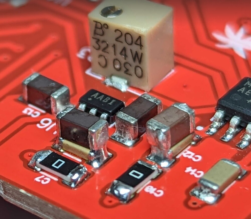

BTW, I'm curious about the two places where you have a large-ish value capacitor (10 uF or 4.7 uF) in series with a 0.1 uF. What's the rationale for that? I expect them to be in parallel.
Thanks everybody!
@DaveEvans ah crap, that's a bungle. I couldn't have been thinking there. What I have gives 1/(1/0.1+1/10)=0.099uF, so basically the larger capacitor does nothing. Do you think the mistake is significant? To fix it properly I'd need to order a new board and solder everything again. Two boards actually, as I made the same mistake for the bed force sensors PCB.
The goal was to smooth out any low frequency voltage dips. For the charge pump and mux, I added a 10uF "just in case". For the ADC, the datasheet showed the 4.7uF (wired properly!). I do still have 10uF where +3.3V comes into my PCB, so it seems that should just about do the same job, if a little slower than 4.7uF.
Hmmm...
Not only are the larger capacitors not doing their job, my guess is that the 0.1uF capacitors are less effective due to the additional ESR of the larger capacitors.
But my approach would be to try it as-is and see what happens. :slight_smile:
OK, thanks. It works in my testing, so I'll keep it in mind if I run into any issues.

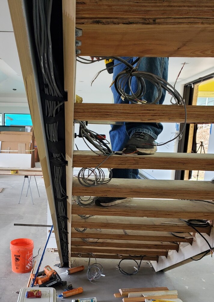

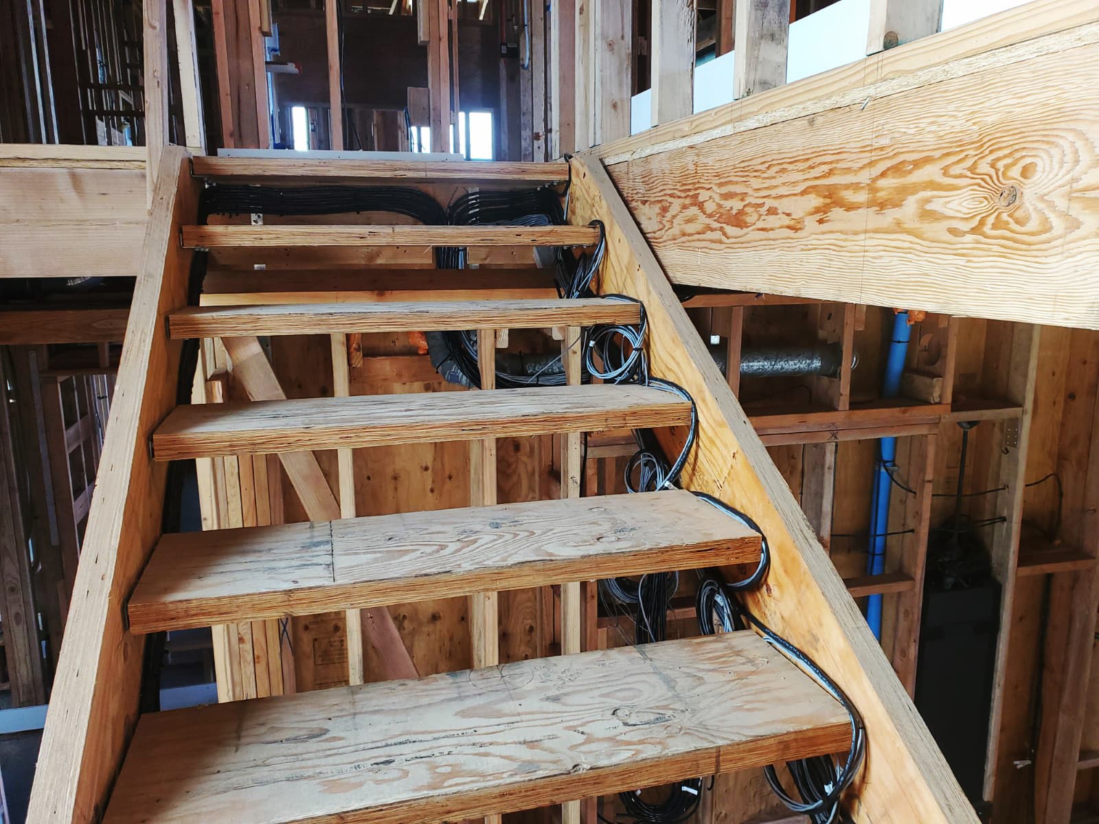

Here's the current state of the stairs:
16 wires for LED strips, 16 wires for sensors.
I suggest you replace the large value series capacitors with wire links. They are not doing anything useful and are probably degrading the performance of the smaller ones they are in series with.
Thanks. I had trouble getting to sleep last night and had the same thought. I'll replace the 10uF with 0ohm jumpers.
BTW: nice soldering equipment!
Thanks! It's unnecessary, but it's super nice to use.
What do you guys think of replacing the larger decoupling capacitor with a jumper, then stacking the larger capacitor on top of the 0.1uF? That seems like a reasonable way to achieve the original intention without remaking the whole board, as long as there aren't any proximity issues (heat, vibration, or something else).
No problem with that.
Not my proudest work, but it is done. Behold, capacitor piggybacks:
Oops, didn't notice the IPA left some residue. Better than flux I suppose.
If it makes you feel better, I've seen the same thing done on a $3million+ project :slight_smile:

A little update, cladding on the stairs and tidy wiring:
There's 16 cables to force sensors on one side and 16 cables to LED strips on the other side, for individual control. It will still be quite some time until it's functional.
