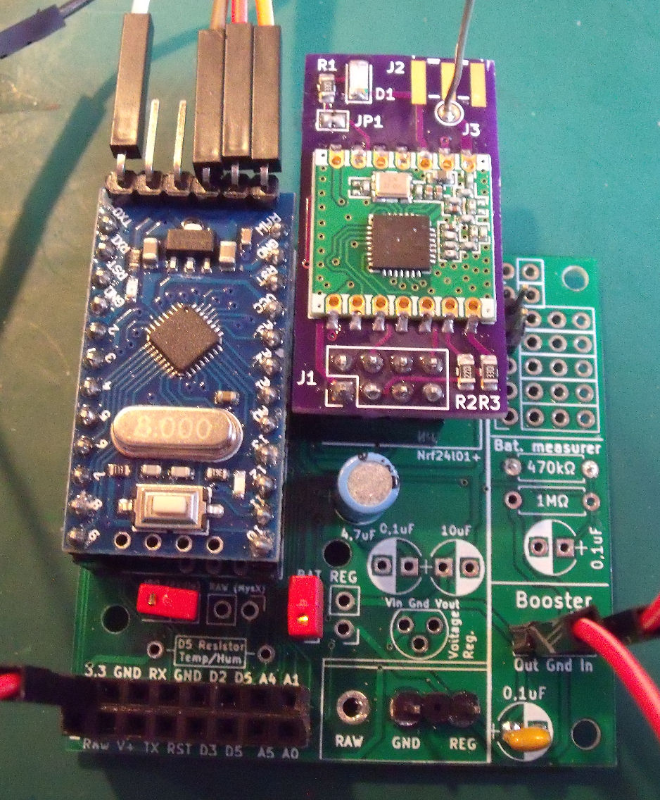

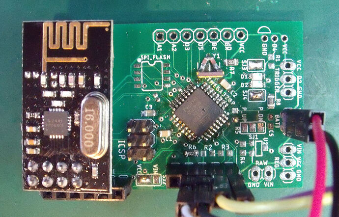

I currently have several 328P boards that I made up from bare boards bought on ebay (AA-Node). They each have a DS18B20 temperature sensor on them operating in 3-wire mode. They were designed to work with an NRF24L01 (not the LNA+PA) variant, but there's no reason why they couldn't use the LNA+PA variant. These units run off 2x AA battereies and currently report the temperature every hour (give or take) using the RocketScream Low Power library.
I started with the NRF24L01 radio but they didn't work very well (poor range) in the scenario I wanted to use them. I designed a simple PCB to allow me to use an RFM69CW radio unit as a drop in replacement for the NRF24L01 and that's working pretty good.
The AA-Node really is a bare bones board (the rectangular board in the photos). Another alternative is the MySensors board (the square board in the photos) that takes a Pro Mini module. Both take an NRF24L01 radio module.
This is the MySensors board:
This is the AA-Node board (minus the DS18B20 that goes in the top right corner):
UPDATE: I just checked the battery voltages (basic Energizer AA batteries) being reported and one of my nodes started out at 2.956v on the 13th. 5 days later on the 18th it is reporting the battery voltage from the same 2x AA batteries as 2.903v.
I forgot to add the photos of the exact same boards with the RFM69 radio modules installed:
