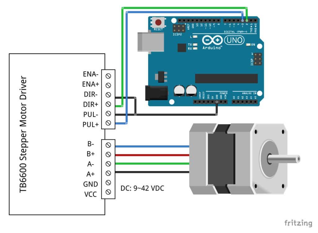

You are using the same pin for two different devices. Did you write this or download it from ChatGPT?
You uploaded the wrong image. This is not a schematic.
Upload a drawing of the six motors, the DM556, the wires connecting them, the Arduino, the Power Supply... similar to this...
