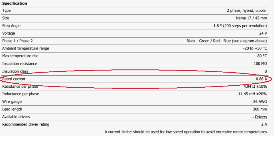

I drive a peristaltic pump with a stepper motor at continuous speed (Yeah, I know it's better with Brushless but It's really difficult to find brushless peristaltic pump. The seller assured me that it can work continuously).
My project needs that the pump works 24/24 7/7 without blocking function (I need to control others pump and sensors). For this, I use the AccelStepper Library test that you can see below.
But the motor of my pump is very hot ... I set the current limit of the TB6560 to 1.9 amp and I work in full-step mode. I set 1.9 because the datasheet recommended a driver of 2Amp.
Whit this code, I don't know if it is interesting to change the step mode. I can works from full to 1/32 revolution.

How hot? It is not unusual for a stepper to run so hot that you cannot hold a finger on it. The stepper data sheet has the max temperature rise at 80 degrees C. If it is running under that, it should be OK. You can dial back the current if the heat is a concern and the motor will still perform satisfactorily.
I almost can't hold a finger on it so yeah It can be 80 on average.
Do I need to add extra ventilation? Only ten minutes at 48 rpm provokes this max heat.
With my driver, I can downsize the current from 1,9 to 1,4 amp. But the datasheet recommended a 2amp driver so ... I think it's not a good idea.
When I talk with the seller, she could give me the relation between flow rate and RPM.
But how I could know the relation of stepper.setSpeed() and the RPM ? I know that stepper.setSpeed(275) corresponds to a 46 rpm (because I have the same flow rate as the seller) but if I increase or decrease the Speed I wanted to know the RPM value.

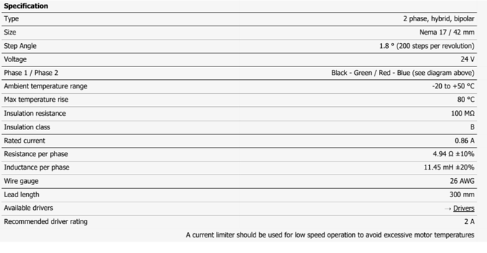

Stepper motor data sheet says 0.86 amps but You tell You use 1.9. That motor will be destroyd.
As @Railroader has pointed out 0.86A, the controller to be used is recommended to be a 2A unit.
You still need to set its current limit to closest to 0.86A.

Oh I thinked that the "recommended driver rating" was the current limit.
I will set to 1AMP.
But thus I don't understand the notion of "recommended driver rating". If the current limit is limited to 1amp. Why it's important to have a 2amp driver ? Is there some peaks current greather than the current phase ?

That could be the case, but it is done in a lot of situations, you over rate the driver to ensure reliability and consistency of operation.
If you have a 200kW car, you do not run it at 200kW 24/7, it probably would not last that long.
If the datasheet says 0.86A, don't set it to 1A! That is still overloading it. I would recommend setting it slightly below 0.86A, say 0.8A. Your motor will get hot and will not last long if you exceed the specifications.
Okay I will set to 0,8Amp.

Because running things close to their maximum limits causes all sorts of thermal
issues and reduces lifespan. Just because a car has a top speed of 120mph doesn't
mean you drive it at 110mph all the time and expect it be reliable.

A simple answer to this is that the number of phases does not affect the current limit, because at some point in the stepping sequence 100% of the current will be directed to one phase with 0% (or -100%) directed to the other.
For some stepper drivers (e.g. DRV8825) you can set the current limit to 1.4x the single phase current, because when in full-step mode only, the maximum current through each phase is only 0.71x the current limit. See Table 2 in the DRV8825 datasheet to understand this further.
I would strongly recommend that you look at the datasheets for the motor and the stepper driver that you intend to use, as they fully explain everything you are asking. For example, page 11 onwards in the TB6560 datasheet clearly shows that 100% of the limit current is applied to each phase regardless of excitation mode.
Try to read up on how the stepper motors and their drivers actually work - they are driven by approximately sinusoidal currents that are at different phases in each motor winding. It is actually essential for correct operation that the current limit is triggered, so it needs to be set correctly for the motor to step reliably, it isn't just about setting it as high as possible to drive the motor to it's limits. If you are finding a stepper motor rated at 0.86A is insufficient for your needs, you need to buy a higher rated one, you can't just push it harder and hope everything will be OK!

For the DRV8825 you should set the current limit to 0.86A if you are using micro-stepping (1/2 to 1/32) as it will reach 100% of the limit. If you only use full-step then the current will only reach 0.71x the current limit that you set, so you can set it to 1.4*0.86 = 1.2A. It is always good practice to reduce these currents a little to add a safety margin for your motor, so if I were in your position I would reduce the 0.86A to 0.7A or the 1.2A to 1A. You just need to decide if you are going to use micro-stepping or not.

The datasheet shows that 100% of the current limit will be drawn by each phase, so set the current limit to 0.86A.
DRV8825
The datasheet shows that only 71% (0.71x) the current limit will be drawn by each phase, so set the current limit proportionally higher - (100 / 71) * 0.86 = 1.4 * 0.86 = 1.2A. You are setting the current limit to 1.2A so that the motor still only gets 0.86A!
If you re-read my post you will not see that I set the current limit to 1.4A at all...
You are really confusing yourself with the idea of the two phases. The current limit that you set on the driver applies equally to both phases i.e. in your case 0.86A maximum per phase. This is also the value usually quoted in stepper motor driver datasheets - the maximum current per phase (or coil).
I suggested dropping the actual current limit from 0.86A to 0.7A because of real world engineering experience. If you push any component including motors to the limits suggested in datasheets they should still work, but you will run at higher temperatures and likely reduce the lifespan of the component as a result. Therefore for reliability I would suggest not pushing to the limits. My figure of 0.7A is therefore an educated guess.
As to whether 0.7A is enough to drive the motor the answer will almost certainly be yes. The question I cannot answer for you is whether or not it is enough to drive your pump. To give you an idea, I have used some 1.3A (maximum per phase rating) and set the current limit to 0.8A and driven small three axis CNC machines with a lead screw successfully. The motors ran cooler as a result. Try it and see! If you find that you need to push the motors to or beyond their limits to drive the pump then you should have bought a more powerful motor with a higher maximum current rating.
