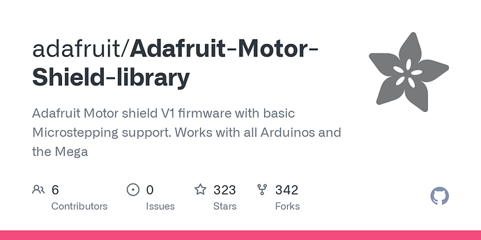

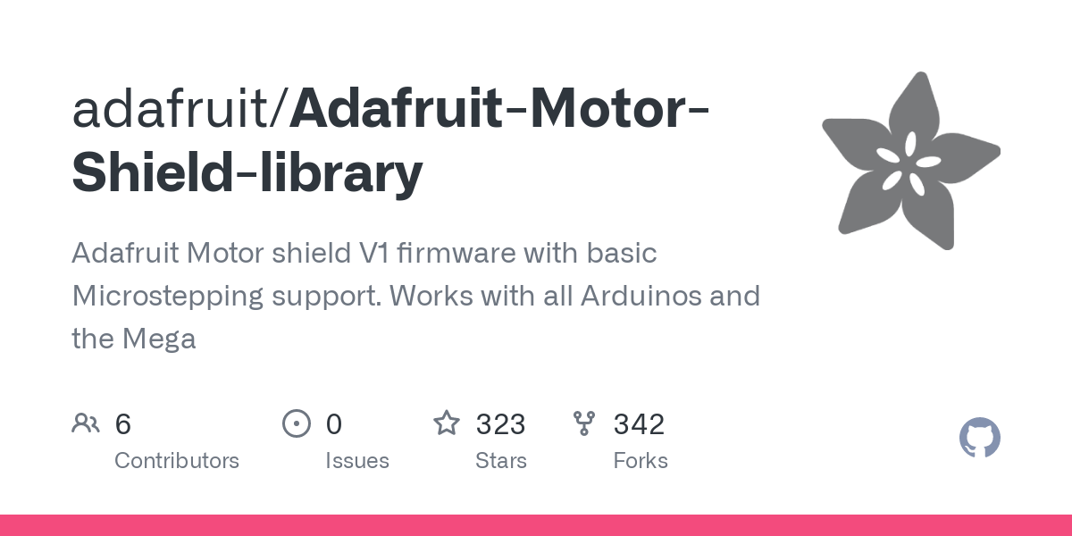

This is where I downloaded the library from.
The instructions can be found here on the left hand side link list towards the bottom under "Download PDF"
I found this syntax for making the motor move a given number of steps. It is not like your syntax. Could that be the problem? Note that there are no negative values. RTFM ?
