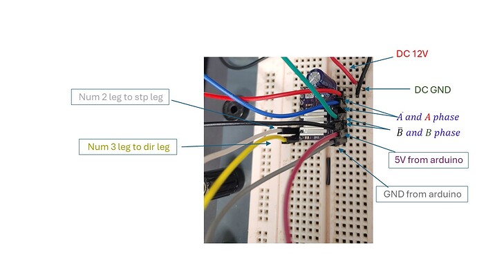

Hi, as per your advice, I purchased a DRV8825 driver and connected it to a motor with a 220 UF capacitor in full-step - mode, When I operate the motor by toggling the STEP pin on and off, it works properly. However, when using library functions such as AccelerateStepper, even for the simplest commands, it simply vibrates and does not rotate. I'm attaching a video of the motor's response to the following code

Connecting Scheme:

Is your motor supply GND connected to your Arduino GND?
Please show the sketch that works with exactly the same wiring.
The wiring in your picture doesn't fit to your sketch. We need a schematic how exactly YOUR project is wired.

I hope the following picture explains the connection scheme well.
no..do i need to do this ?
Yes, although looking at your diagram, it might be done implicitly through the two GND connections to the motor driver. I would do it externally, regardless.
