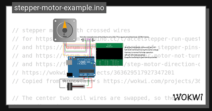

For those who have a stepper motor that only goes one way.
Here is a common fix.

Ah, "pair" is the "pair of wires driving a coil", not the pair that need swapping.
If the motor only goes one direction, the wires to the coils may be crossed in the connector. Swap either the outer pair (or the inner pair), so the pairs of wires driving each coil are adjacent, as in the connections to the stepper driver below:
(image credit: Pololu - DRV8825 Stepper Motor Driver Carrier, High Current)
Note that some carrier boards label the coil wire connections differently, so you can't go by "put the As and Bs (or 1s and 2s) on separate coils". For example:
(image credit: Pololu - A4988 Stepper Motor Driver Carrier )
Swapping a single pair on a single coil will change the direction of rotation. (As will flipping all 4 wires)

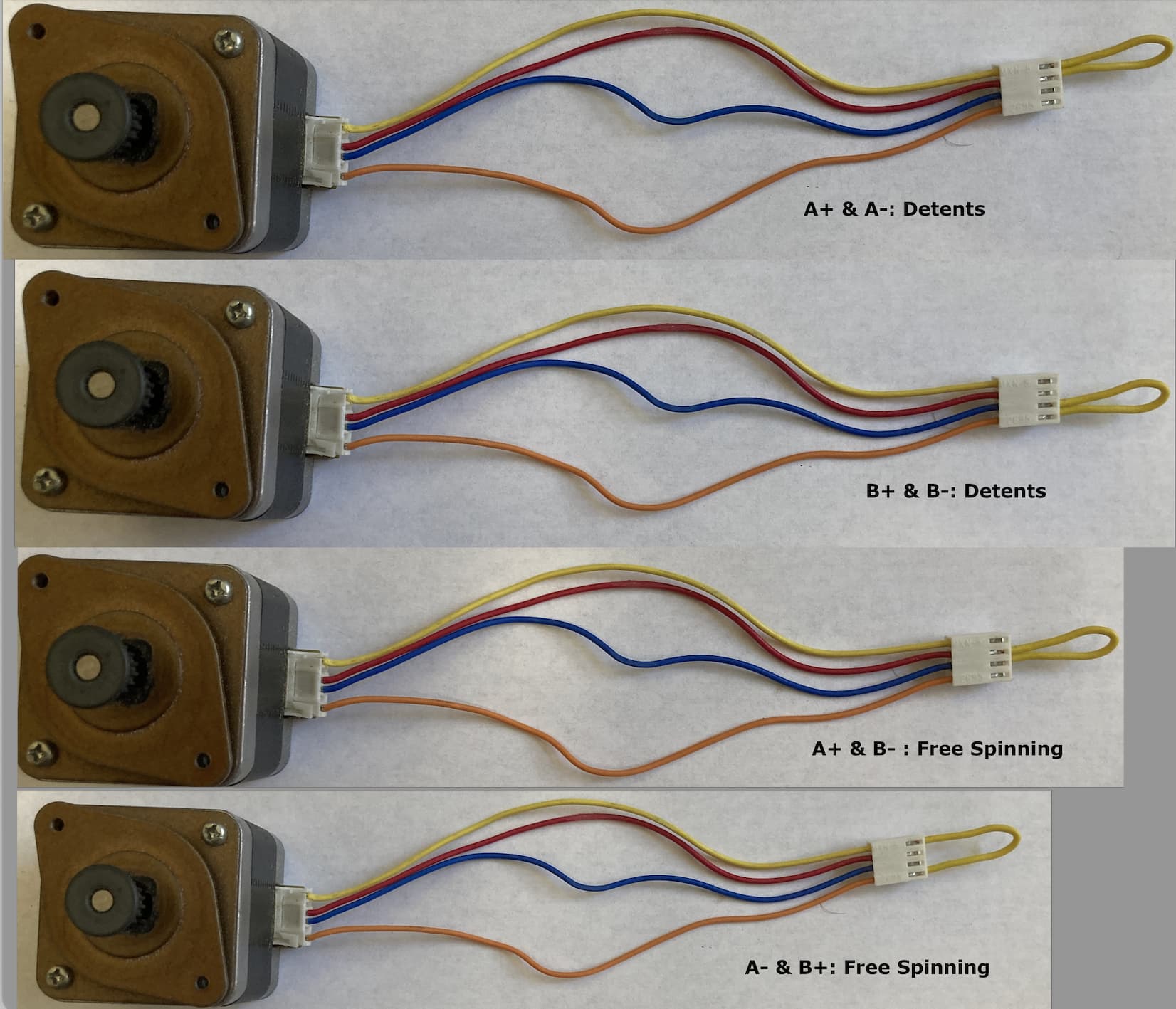

You can check if you've got the coils properly identified by shorting a coil and seeing if you feel detents as you turn it:
If you don't make a circuit and feel detents when you short the two wires of a coil, you've either misunderstood the coil wiring or have a burned out coil.
