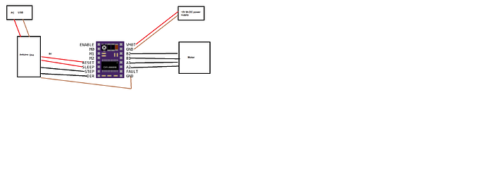

Do you have pictures of your layout or a schematic or both even.

Can we please have a circuit diagram?
An image of a hand drawn schematic will be fine, include ALL power supplies, component names and pin labels.
Your circuit diagram, reverse engineer your project.

The best circuit diagram I could make, not sure this is what you asked for.

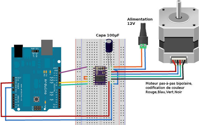

No capacitor between vmot and ground.
yes I know its not your picture but the arrangement applies.
BTW I do not support the use of breadboard for motor usage.

Is that capacitor necessary for proper function or just there to stop voltage spikes? I do not have any capacitors, and if they are just there to stop the drv8825 from dying I'm willing to take my chances.
Is this a problem in the python code aswell?
You will probably need a spare driver if you are going to take chances like that.
Pretty much all the examples I can find have the capacitor !
Consider scavenging one from some old electronics.
Those that don't have the capacitor are living in a dangerous world of chance and fate.

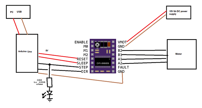

I'd be interested to see the signals coming out of the arduino to the motor driver bracketing the abrupt stops. You could put LEDs on the signal lines, which will flash to indicate change of state. Hardware debugging :slight_smile:

If you are connecting just the boards as shown, and the motor shaft is not under load (free running), your wires are connected properly and of reasonable csa and length, it's a bit difficult to diagnose remotely. Connect a resistor and LED as shown, run your sketch as before and observe the LED and motor behaviour.
