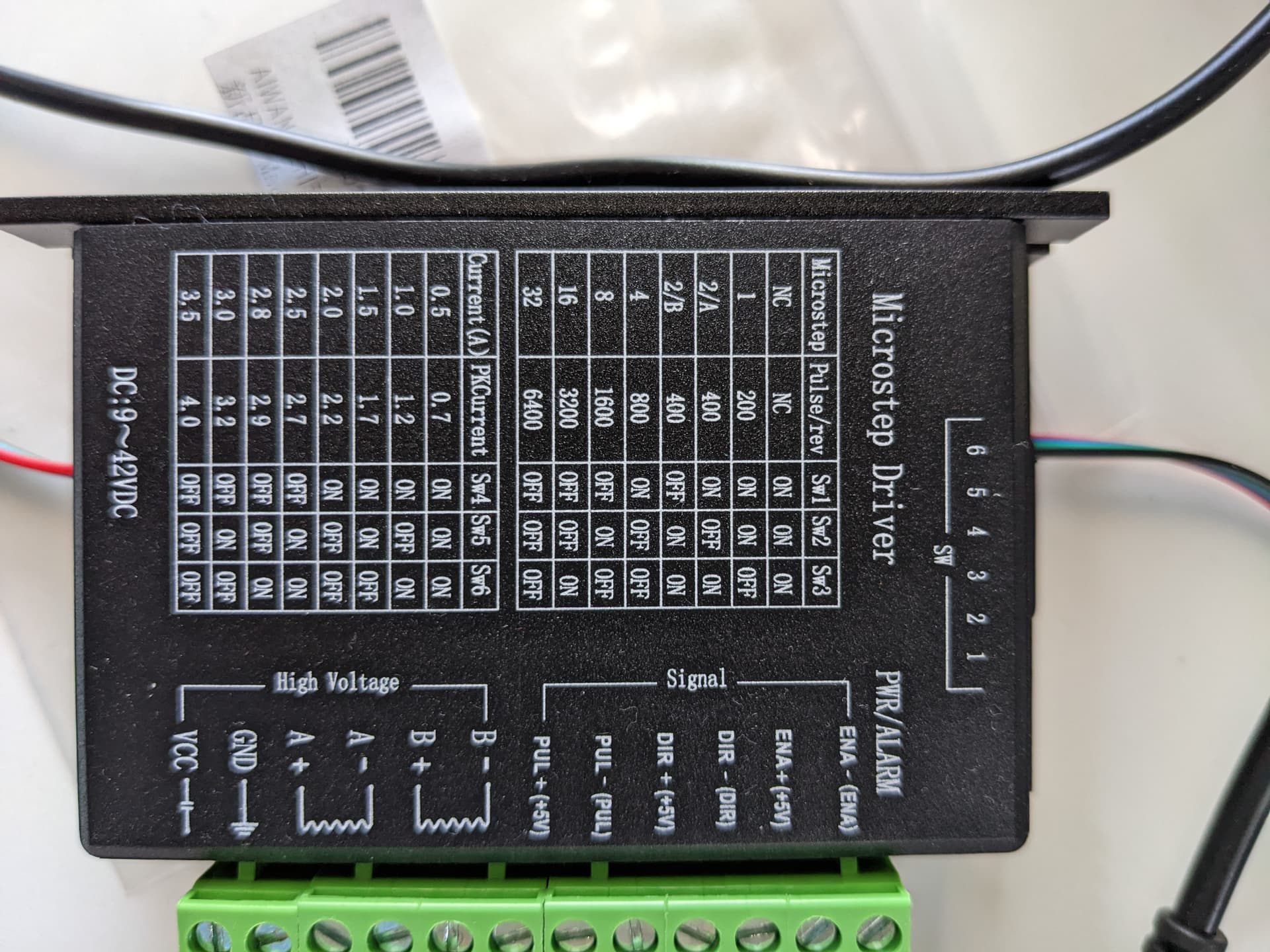

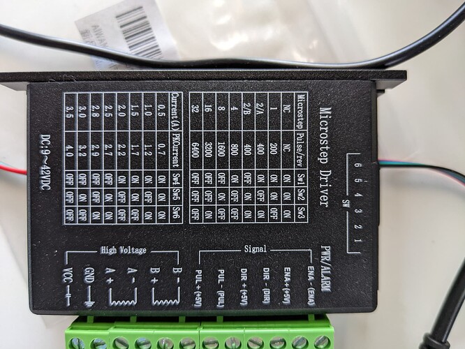

Pictures of the TB6600 switch diagram, and my current settings should be attached. I have the "microstep" "pulse/rev" set to 4 / 800 respectively, and the current set to 1.5A. (1.5A I believe I pulled from the datasheet of the motor, 4/800 was chosen just via trial and error with many settings to get the motor to spin at all, as otherwise it would just vibrate, although I haven't done exhaustive testing between different pulse settings and different timings).

How do you power the stepper
I'm using an AC/DC adaptor plugged into my wall. Output is 12V, 2A. The power / ground of this goes directly into my TB6600.
how did you set the current limit?
I have set the TB6600 switches to 1.5A. I've uploaded 2 pictures to the main post to demonstrate.

I'm using an AC/DC adaptor plugged into my wall. Output is 12V, 2A. The power / ground of this goes directly into my TB6600. I have set the TB6600 switches to 1.5A. I've uploaded 2 pictures to the main post to demonstrate.
That's 3A for two coils but 3.4A recommended for the motor and your PSU can only provide 2A.
Understood, I'll order a new PSU today and update thread once I've tested. May I ask where the 3.4A is coming from? Is that from doubling the "Amps / phase" from the motor datasheet?
