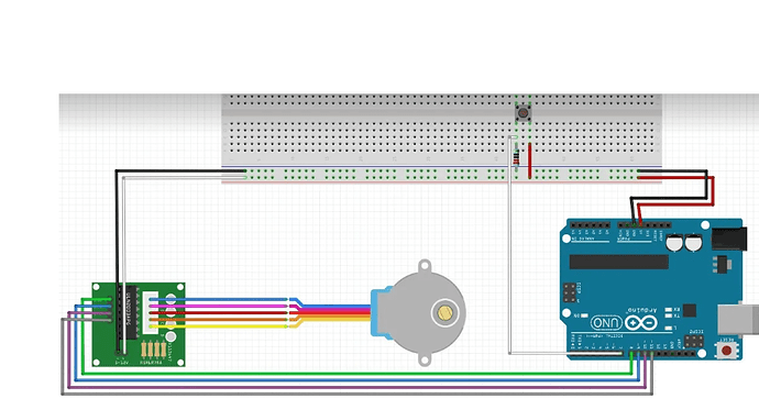

I have a Arduino uno board, 1 press button, a 28byj-48 stepper motor, and a motor control board.
I would like it to: When i press the button, I would like it to start turning, TILL i release it at a slow speed And should not turn without being pressed. I only want it to turn 1 way.
I have programmed a code of what i know..... And it doesn't do what i want it.
This is my code and how my Motor is set up

What does it do?
No button in that poor presentation. How is it wired? Please use schematics (pen and paper). No power supply presented.
Good practise is to use INPUT_PULLUP and wire the button between GND and input pin.
For a 28BYJ-48 motor the steps per revolution is 2048, the maximum, RPM, without missing steps is about 12 ~ 13.
So i am using a 5 volt usb cable connected to arduino. So what it does right now is
When i plug it in, it starts turning, and then it stops for a while. when i press the button it goes the other way for a while. if i wait for a while it will then start turning again the other way. When finished
it instantally starts turning the firsts move.
What i want it to do is when i press button and hold it, i want it to turn at what ever speed. and when i stop pressing the switch , it should stop.
