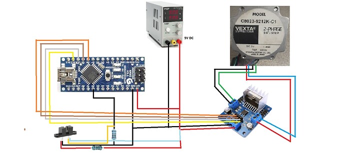

Hello,
I wrote this code to make the stepper motor run forward untill analog pin 2 is high and than it should run reverse, untill it's high again to run foward again and so forth.
But when pin 2 is high the motor stops and is just humming.
What am I doing wrong here?
Any help will be much appreciated!

Sounds like the motor is changing direction (repeatedly). What is connected to A2, and how is A2 changed from > 512 to < 512 to allow the motor to not keep changing direction?

I'm using an optical sensor H21A1 with a 100 ohm resitor serial on the + and a 1k ohm pull down resistor paralell to ground on analog pin 2 of the Arduino.
The code and the optical sensor is working, because the motor stops and humms when it reaches the optical sensor. The problem looks like its stuk in a loop when it reaches the "else"part of the code.
In the serial monitor, I can see the value going from 928 to 6 on the analog port when the sensor is closed.
It's a very simple code, but I can't quite jet find the problem, or solution.

Proper schematic please then people can see better.
Pictures too !
Some "stepper" motors have strict limits on the steps, pulses, speed, and right now we have very little to go on.
I use an optical sensor to do this, I see the value change in the serial monitor from 928 to 6 when closed
If you are unwilling to provide a schematic or pictures then I feel it only fair to tell you that some of us may step away from this topic.
Can we please have a circuit diagram?
An image of a hand drawn schematic will be fine, include ALL power supplies, component names and pin labels.
With photo-interrupters you should not need to use analog input, digital input should work fine.

It takes a while to write a schematic, please see the post below :slight_smile:
