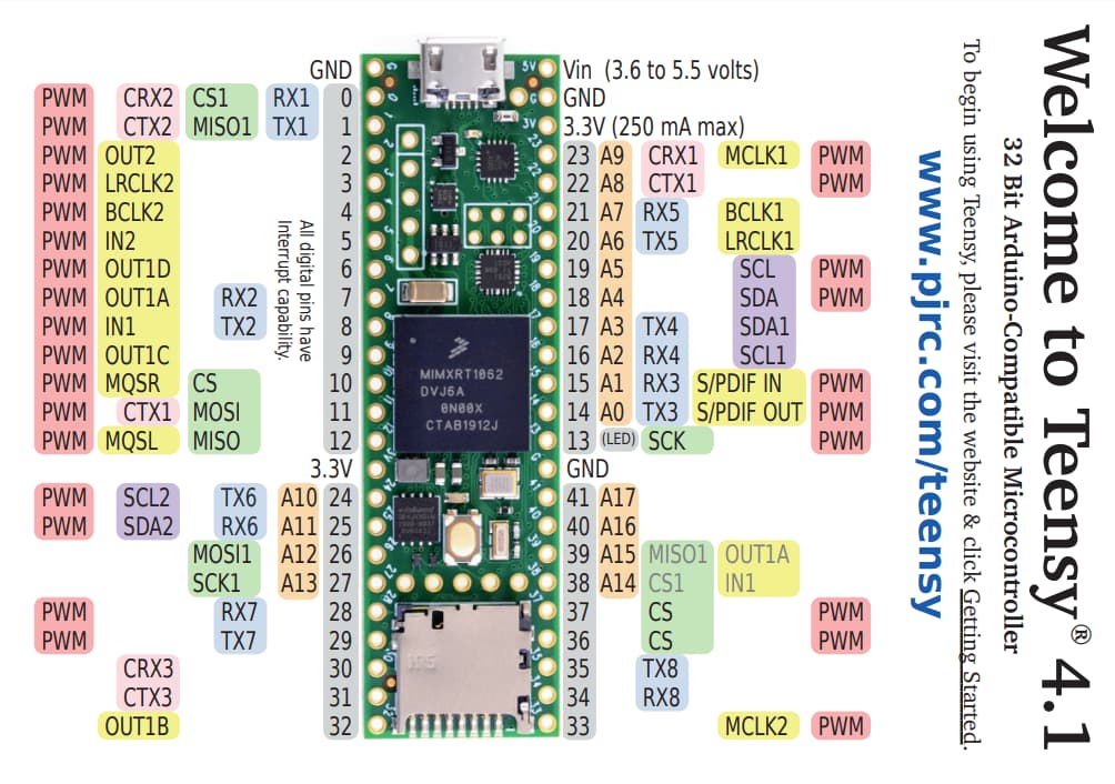

I am using the Teensy 4.1 controller

This is the Teensy 4.1 pin layout.

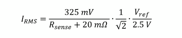

Not at all. 24V and 36V motor power supplies are common, and more efficient. Make sure that you have set the current limit on the driver to 1A per winding or less.
@jremington I have Vref set to 0.83, which should give me 0.9A limit as per this resource suggests using the formula, with Rsense of 100 mohms:
