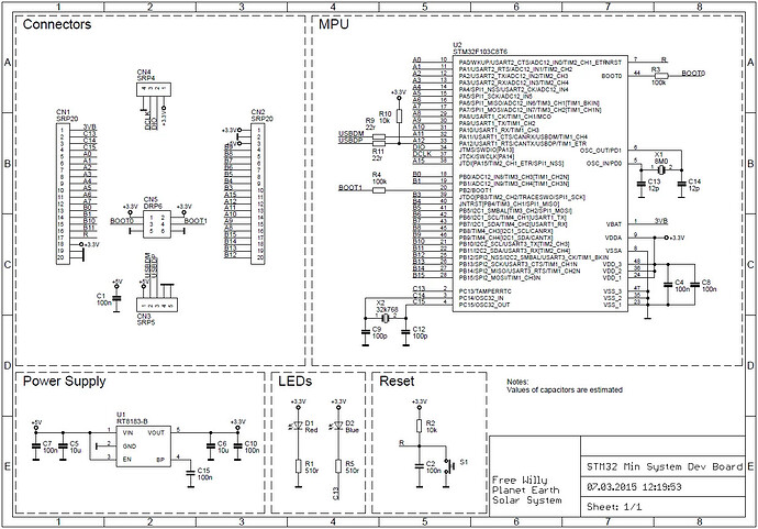

STM32F103C8T6 module, AKA: Blue Pill schematic
Not that the world really needs yet another. However in my rummaging for a clean and unified schematic for this board I came up short. So I did a quick take-off relative to a few slightly different boards at hand which is attached. Feedback pointer in schematic.

I think I'm confused. How is the fact there are already schematics out there a motivation?
I encountered both printing issues with the embedded chinese character fonts and the fact the existing schematics weren't a conventional integrated drawing. The capture here was offered in the event it would be useful to others facing similar issues.

OK, but to make a critical remark on this: while your rendering is a unified schematic, it does simply switch the functional blocks for an equally opaque bus. Not that it matters a whole lot since you need to deal with the plethora of nets in some way. But in the end, it doesn't matter much which option is adopted, as long as all nets are labeled clearly.
Technically speaking, your design is a few decoupling caps short. But it'll work as is.
I'd also prefer a slightly more beefy regulator; the XC62xx are nice for their low dropout, but they're also very frail devices and prone to destructive decomposition if pushed only very slightly out of their comfort zone. Especially the XC6219 is a little tricky with its 6V max input; it doesn't take much to fry it. Omnipresent and equally cheap AMS1117 is a little more crude, but also stands up better to abuse.
NB: this isn't my design but rather an attempt to document the standard issue Alidepress blue pill boards shipping at present -- warts and all. While there seems to be minor variation in the actual PCB layouts, the electrical schematic reflects what I've received among the variations from China Inc. of late, and differs from the older schematics I've encountered rummaging online. That difference was the motivation to document what I've wound up with and I speculated what others have been receiving at present. Having sunk time to capture the schematic, I thought to amortize my effort by sharing with others. No more, no less.
And yes I agree if this had been my handiwork I'd have sprung for full boilerplate decoupling at all VDD/GND pairs. In fact I intuitively had them in the drawing when originally sketched up. But then realized this didn't jive with the PCB and pulled out the caps formerly @ 47/48 and 8/9 to most accurately reflect the PCB.
