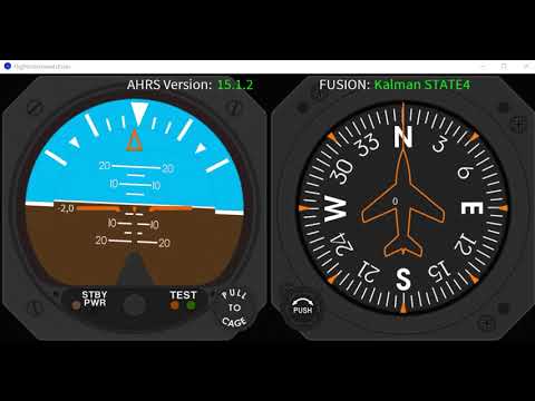

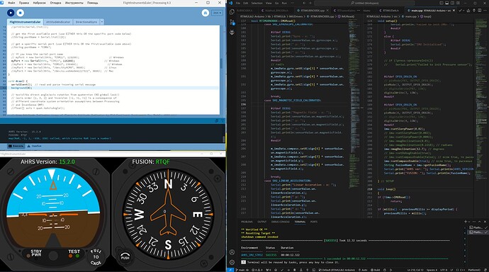

In general, a question about the strange behavior of the RTQF and KALMANSTATE4 algorithms.
GUI on Processing from GitHub - VoxMi/MPU-9150 with minor modifications.
The RTQF algorithm, when the device is first turned on, for some reason has a rotation around Y axis and begins to align it to the normal position of the sensor.
But it's as if the Z axis has gravity pointing upward.
The KALMANSTATE4 algorithm works perfectly when first turned on, all the axes are correct and there is no additional rotation.
I tried changing/deleting some lines from the source files, it seems like the function
predict()
affects the result of the axis flip.
But I can't understand more.
In general, the algorithms work, but the nature of the orientation flip when running the RTQF algorithm is unclear

The only question is about the algorithm RTQF
For some reason it starts with a flip and rotates the Y axes.
The algorithm KALMANSTATE4 starts normally.
Otherwise, the algorithms work correctly and the entire orientation is correct with minimal errors.
I want to find the start moment in the code and so far I have not been able to do this :roll_eyes:
Maybe there is some peculiarity of the algorithm RTQF initialization, but I don’t know about it?
