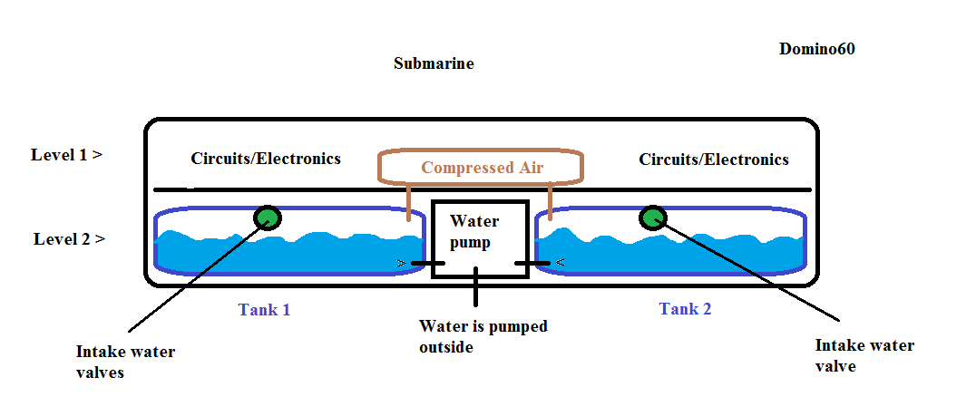

Here is my idea:
My basic idea is to use the water pump only to pump the water outside, the water tanks will be filled
naturally like a bottle under the water, the air gonna get outside and the water gonna come inside,
after we finish our work/tasks, we use the water pump to get the water outside and the air tank to fill the water tanks with air again.
As you understand there gonna be needed few servos to open the tank 1 and 2 valves and another servo to open the compressed air valve.
at this point the submarine will go down and up :slight_smile:
ps Do not be scared of the paint :smiley: work
EDIT:
If the OP is a advantage user in any kind of project I suggest him to use a DC Motor and create a
air compressor to compress the air from the Tank 1 and 2 in to the compressed air tank so like that
the air will be never lost.
D.60
