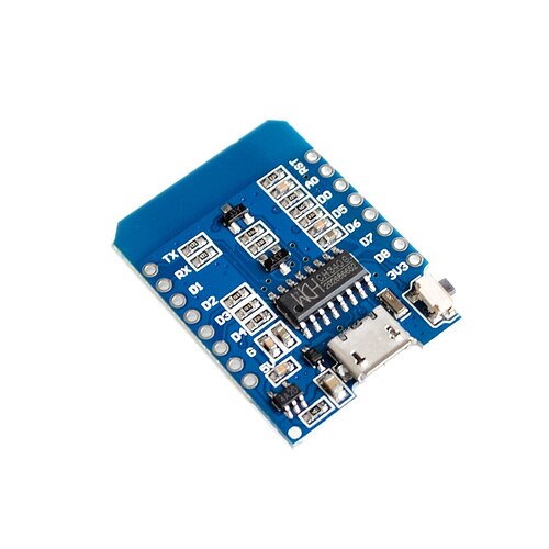

If not everything is purchased already maybe a wemosd1 might be a solution. A bit less pins than a uno but enough for a couple odd sensors. Plus toy can just plug in a usb cable. And it is cheaper than a uno and esp8266-01 module together.
less than a beer at the bar
Bringamosa:
WeMOS D1 mini.
Excellent all-round workhorse. :grinning:

NodemMCU and Wemos D1 mini are almost identical.
