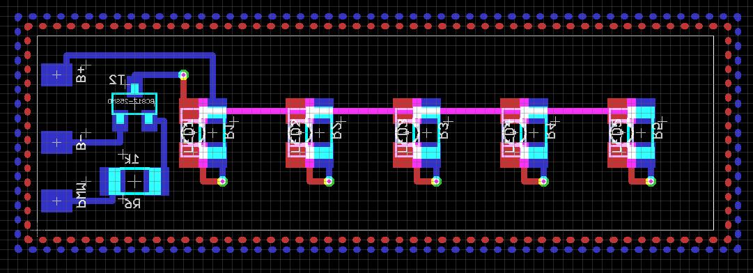

hey guys.. wondering what suggestions or what you have used in your projects as far as SMD transistors go..
overview:
I want to make a simple PCB that has a certain amount of leds in a line across the pcb (pcb is roughly 1.5" long x .5" wide)..
anywhere from maybe 4 leds to as many as can fit across.
most likely the leds will be smd variations of some kind.. (most everything I have looked at as been around 3.1-3.3v and fV of no more than 20)
I want to be able to PWM control this 'strip/pcb' of leds (all at once) from an Arduino pin.
Knowing the current draw will be too much for a single Arduino pin to handle... I know I need something 'else/more' to achieve this.
Figured using a simple transistor to 'bridge' this gap, (having the transistor supply/control the direct power supply to the leds...andhaving the Arduino PWM the transistor)
I have a few questions that will hopefully help me make a better decision.
1.) the leds are NOT set-in stone yet...... that being said I was thinking about using 5050 SMD leds (one color).. maybe 4 of them..
the 5050 leds are really 3 smaller leds in one package/housing.. (ie; there is 3 GND and 3 POS pads on each 5050 led)..
I dont have a problem 'bridging' all GND pads and all POS pads together in the schematic/board layout.... more or less treating it as 1 led
my question is... if I use 1 resistor to limit the current it gets (as a whole).. let say to 30mA for discussion sakes.. (normally it would be 60mA,... 20mA per led x 3-leds in each 5050 housing = 60mA total).. but if I put on a resistor that limited this to around 30mA and knowing inside the 5050 unit it truly is 3 separate leds... will they all split up that 30mA equally? or will one of the leds in the 5050 unit be brighter?.. pulling a full 20?mA while the others split the remaining 10mA? hope that makes sense!? LOL
I know I'll need more current than what the Arduino will be able to provide.. but I dont if going with 5050's @ 60mA each is too much?
I'll only have 1 battery pack.. another pcb like this.. (the Arduino itself).. and a servo or two to power..
battery pack will more than likely be a 7.4v li-ion pack of some kind..
so... with all the above explained.. what SMD transistor do you guys recommend? (I cant seem to find a 2N2222 transistor in SMD package in Eagle?) can I use another SOT23 package? like the BC847 transistor series??

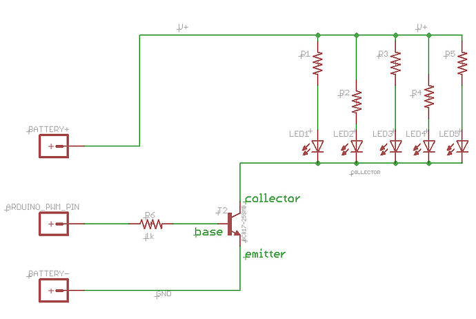

schematic:
I have a question about mine.. and others I have seen..
1.) I have seen some diagrams have the battery+ pad/line (in my schematic) be the 3.3v or 5v lines coming FROM the Arduino?
2.) I have seen some diagrams have the GND line from the Arduino be used and tied into the GND line from the battery source/pack?..
Why? Im failin to see what part the Arduino circuit plays into this (powering the leds) if it can not give enough current.. 'and' a transistor is being used instead? (maybe it was showing the Arduino GND to imply they needed to be joined together?)
thanks
Most cube projects have a transistor involved...
In this thread CrossRoads gave me some advice for my component needs including a FET.
http://arduino.cc/forum/index.php/topic,115625.0.html
I'd go with FET with low Rds, otherwise have ~0.7V across the BJT transistor.
LED with resistor each is smart way to go.
You can make a 3-pad symbol quick enough xl97, I've seen you do it before :wink:
Power from your battery as shown, adjust the resistors for whatever that voltage is. No point burning off voltage in the regulator just for LEDs.

You mentioned running from 3.3V.
With a FET, the voltage drop across the FET will be Rds * current. With 0.05 Ohm (50 milliohm) FET and 60 mA of current, that will be just .003V, so you have 3.297 to go across your LED & resistor. With a 3.2V Vf diode, that could be enough to drive it.
With Vsource of 3.3V and a NPN, and Vce = 0.7V, you only have 2.6V for the LED - not enough to turn on.
N-channel logic level MOSFET with low Rds will get you there.
With Vsource of 5V, the 2N2222A will do.

Not really sure how exactly you are trying to do. But a few things:
  1. a sot23 bjt is good for maybe 50ma on a good day; and a mosfet of that size maybe 75 - 100ma.
  2. sharing one resistor for a rgb led may not work, depending on which type of led it is.

CrossRoads:
Vsat can be much lower than 0.7V - not confusing Vbe with Vce perhaps?
No, I was thinking Vce.
I see that low Vce parts, which are also low power handling, are available, with some careful searching:
BSS138 is a ~200ma mosfet. Dirt cheap.
It's also the same chip that both Sparkfun and Adafruit use for their bidirectional logic level converter.
I use BC817 for that sort of thing. It's the SMD version of BC337 and good for switching up to 200mA or a bit more. For higher currents, I'd use a mosfet.

The BC817 (npn transistor, cost 1.9 pence from Farnell UK) is a direct replacement for the 2N2222 in your schematic.
The BSS138 (n-channel mosfet, cost 4.9 pence from Farnell UK) is not. You can omit the series resistor between the Arduino and the gate (because it is a small mosfet with low input capacitance), however a resistor between the output pin and ground is recommended, to ensure the mosfet stays off until you have initialized the pin mode to OUTPUT. The resistor value is not critical; 10K is typically used.

I have updated the schematic/layout to include the BC817 transistor (SMD).. and made a quick board layout for it (simple enough)
I have a couple of 'dumb' questions.. some about transistors in general (and those darn datasheets).. and one about extending this with the Arduino..
as you can see its a fairly easy/simple schematic & board design.. (not much to it).. just a pcb of leds for the Arduino to 'control'..

I have a question about usability and the Arduino.... using the same schematic/board files from above...
If I had two of these pcb's.. (each with a transistor, leds..etc)
could I connect this 'second' pcb in series to the first?
basically jumper/bridge from the battery +/- pads from the first pcb to the second.....
but more importantly.. could I use the same PWM pin to control/fade BOTH pcb's at the same time??

basically a transistor will allow a 'higher' voltage/current pass through it (to the target device)....(unaffected..ie: not regulated or anything)... by allowing a 'smaller' voltage/current to 'toggle' the gate and allow said 'flow'...
correct?
Yes. Bear in mind that a BJT is a current-controlled device, unlike a mosfet which is voltage-controlled.
(Vcbo) Collector Base = 50v
(Vceo) Collector Emitter = 45v
(Vebo) Emitter Base = 5v
Does that mean it can have up to 50v connected (from battery/source)...
output up to 45v to the 'target' device..
and can take 'up to' 5v (max) to toggle/control the gate?
No. it can have up to 45V connected from the battery (Vceo). The Vebo rating means that if for some reason you apply a negative voltage to the base, it had better not go more negative than 5V.
Im also confused about the current ratings given.. it is 200mA available or 500mA available? what are the difference between the two numbers given?
(Ic) Collector Current = 500mA
(Ibm) Peak Base Current = 200mA
The collector current rating is the one that matters, along with the power dissipation rating.
Yes, provided that the current draw from the Arduino pin is below its 40mA limit. Currently you have 1K base resistors, so the current draw from the pin per board connected is only about 4.5mA.
my question is.. if the one resistor I use, limits the current to, say, ...40mA going to the 5050 led/unit... how will the leds respond/behave?
Will all 3 leds split the '40mA' equally? will one leds take more? or full mA leaving the others without full or equal current?
They will probably share the current fairly evenly but not perfectly. Best option would be to use a high enough voltage battery so that you can connect the 3 LEDs in series. Then the current draw remains 20mA per 5050 (assuming you want to run the individual LEDs at 20mA).
in the current example. if I changed to 5050 leds.. there are 5 leds.. going to all 5 x 5050 leds would be (5 x 60mA = 300mA) neded per pcb/board!!
Im not even sure the transistor can handle/provide that?.. however if @ 40mA each 5050 led looks and acts fine.. it might be a viable option... (or maybe just more 1206 leds!) lol.. but I 'am' curious.
Connecting the LEDs in series and using a higher voltage supply addresses that issue. But 300mA may be just OK for a BC817 if you reduce the base resistor from 1K to 220 ohms

3.3V is too low a supply voltage to use with blue or green LEDs. If you will know what voltage you will be using when you populate the board, then there is no need for a voltage regulator, if you don't mind the LED brightness going down a little as the battery voltage decreases. If you do mind that, then you could use a 5V regulator.
3.3v regulator is too low? because of the drop across it?
I though ta 3.3v regulator put 'out' a 3.3v stream....no?
wouldnt that be enough to power a 3.0-3.3fV led?
most blue/green leds "I" have currently run at around there... :slight_smile:
your saying If I now the battery source/voltage when I populate I dont need a regulator.. because your saying.. just sue the correct resistor? even its a 7.4v battery cutting it down to 3.3v/20mA... still 'ok' to do?
thanks!..
xl97:
To drive an LED at about the right current, you need either a constant current driver, or a constant voltage and a series resistor such that the voltage drop across the series resistor is sufficient to define the current adequately despite variations in the forward voltage of the LED. For example, suppose your LED has a nominal 3.2V forward voltage at the current you choose, and you select a resistor so that a 3.3V supply gives that current. In practice, the forward voltage varies between different LEDs and with temperature. If your LED actually had 3.25V forward voltage, your resistor would be too large by a factor of 2. If it actually has 3.15V forward voltage, your resistor would be only 2/3 of the required value.
Therefore, when driving an LED from a constant voltage source through a series resistor, you should have sufficient headroom in the power supply voltage so that there is sufficient voltage drop across the resistor (e.g. 1V or more) that variations in the LED forward voltage won't alter the current much.
Also bear in mind that if you are driving an LED through a BJT, the BJT has a voltage drop (typically 0.1 to 0.3V at low to medium currents - look up Vce(sat) on the datasheet), so 3.3V isn't enough for a 3.2V LED driven through a BJT anyway.
