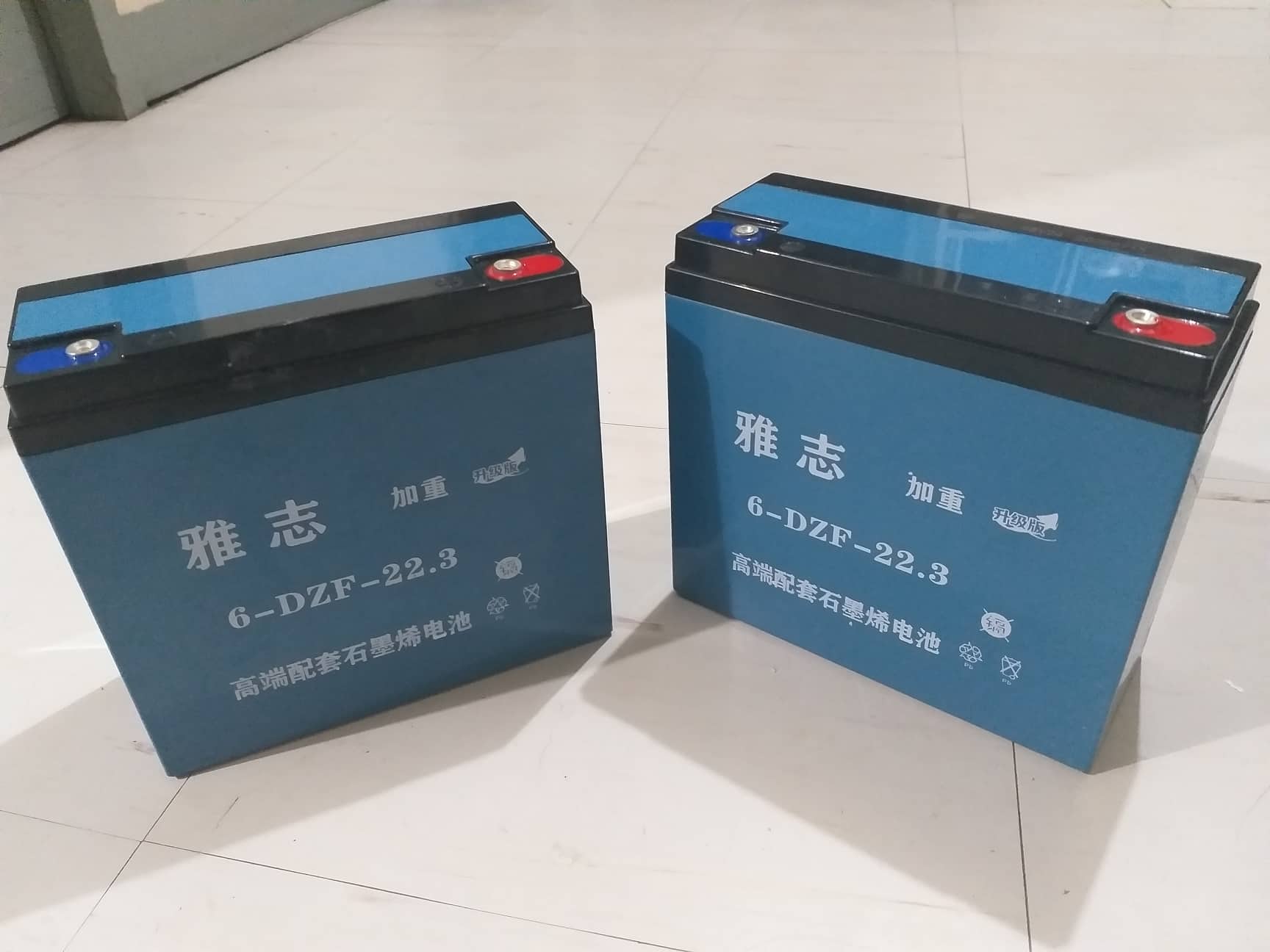

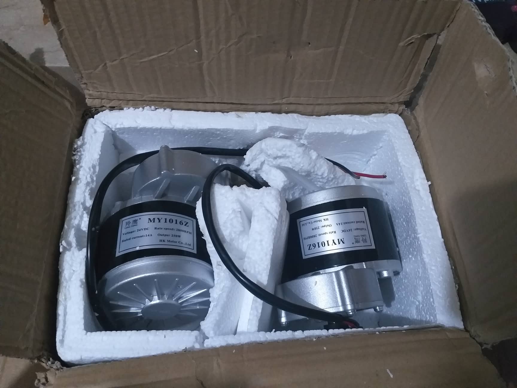

And for the hardware, currently we are using this kind of DC Motor and Power Supply:

Did you blow a fuse in the ground line? There should not be one there it should be in the + supply. The ground of the battery needs to be connected to the ground of the logic unless the control signals etc are galvanically isolated.
