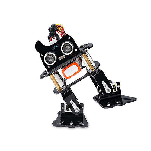

I got a Sunfounder Sloth robot for Christmas. I teach high school computer science, but I'm not as skilled when it comes to robotics, so I'd love a breakdown of what's going wrong here.
I plug the robot in, upload the calibration code, then turn it on. The feet instantly rotate in one direction and it falls over. The legs work fine if I keep them at 0. No changes to the code or the angle of rotation have fixed this. I've tried searching everything, but I can't find a single source that tells me what might be going wrong.
It also seems that it won't recognize the ultrasonic sensor anymore, but that's a whole other can of tomatoes.
Sounds like it is defective. Can you return it for replacement?
Unfortunately no. I actually got a defective servo with it and replaced it with one I had because they need the order number, and it was a gift. So I don't have that number, and I don't know who sent it because it was a teacher gift.
The components shouldn't be too hard to replace. The servos seem to work appropriately, they just won't calibrate right. The sensor simply doesn't work anymore, so that should probably be replaced. Maybe I can get a new nano for it to see if that's the problem.
Are all feet servos tilting at the same angle? If the feet servos are tilting to make it fall over, the rocker arms installed "upside down" or being commanded to that unstable angle by code or are the feet on the right pin assignment? This image shows it standing at 45 degrees.
This video steps you through testing each component, HC05, servos, et c. Video shows "feet" are to rotate to 90 degrees, and the "run" routine is to be commented-out (minute 18:00)
I've triple checked. They are in the correct position, and on the correct pins. I wonder if there's something in the code.
You can post your code here (use the </> code tag).

Would you hold the robot (suspended), "facing" you, and turn it on (multiple times, if needed). Describe what does each of the eight (?) servos do? For example...
Front, left, top servo (FLTS) rotates left
FLBS rotates clockwise
FRTS rotates right
FRBS rotates anticlockwise
RLTS ...
RLBS ...
RRTS ...
RRBS ...
There are only 4 servos. Top left does nothing, top right does nothing.
bottom left and right rotate completely sideways clockwise.
Edit: Also, the ultrasonic sensor no longer works, so I suspect something's gone wrong with the Arduino. I've got a replacement on the way.
Good data!
Do you have VarSpeedServo.h or a link to it?
  • Verify servo pins are RU 9, RL 10, LU 11 and LL 12.
Would you add:
  • inside setup() this line:
  • inside TooClose() these lines:
        Serial.print(" TOOCLOSE ");
        Serial.println(din);
  • Verify trigger is on 4 and echo is on 3. (I know you said you looked, but I need "trig is 4, echo is 3" verifying). I see only one call to ping()... I don't know if that is good or bad, yet.
