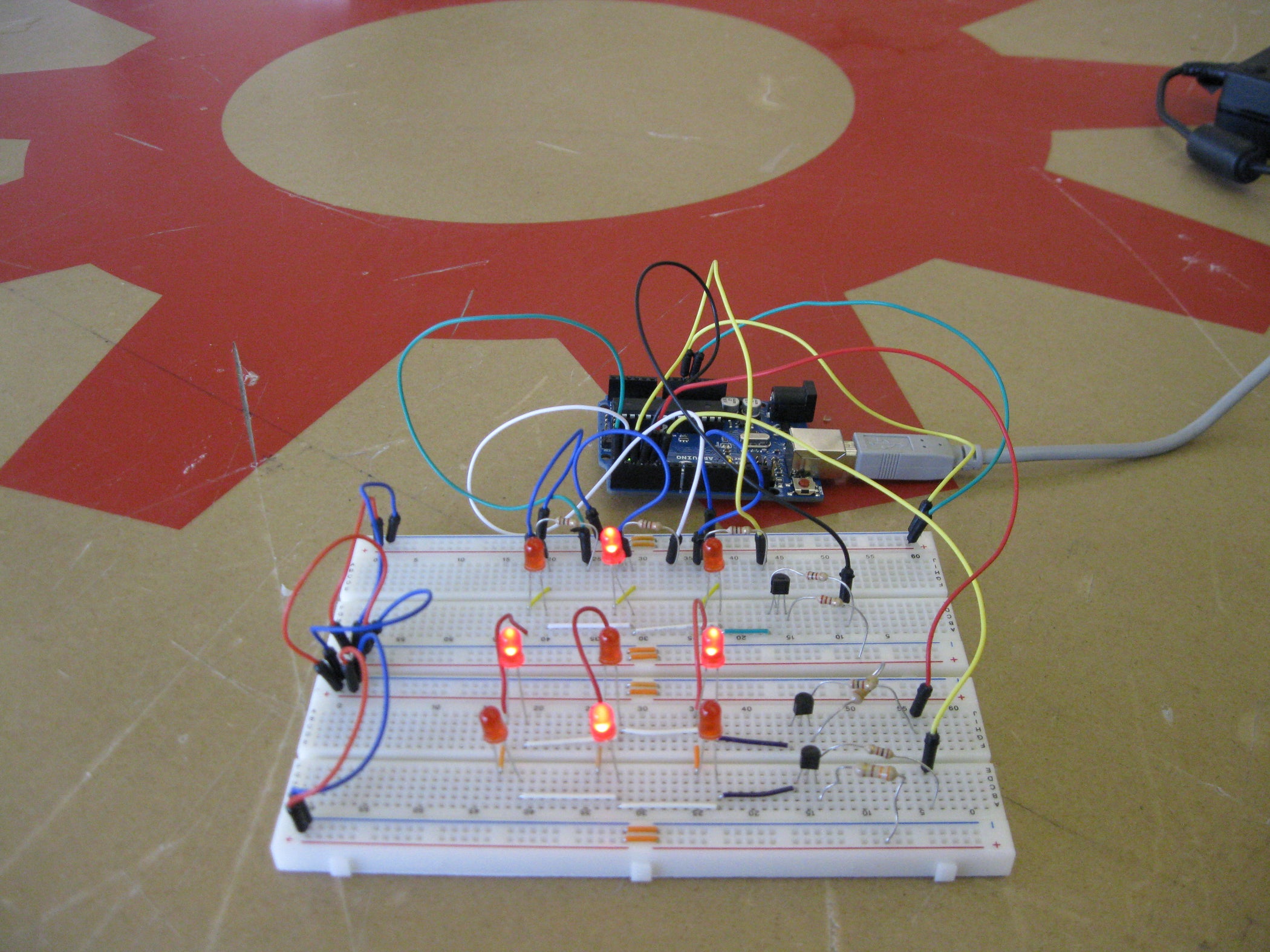

Ok so that is not my problem. Thanks for that. But obviously something else is my problem. I was multiplexing like the first schematic attached (pic1) and multiplexing with code that looked like this:

Which worked out perfectly fine! except for the fact that the arduino due is not powerful enough to handle that many leds so I decided to do some LED driving. So I made the schematic shown in pic2. Please note that it was 4 signals connected to the anodes and 6 signals connected to the cathodes but in pic2 it's 6 signals connected to the anodes and 4 signals connected to the cathodes. I changed the code to look like this:

here are those schematics I was talking about
Here is pic2
pic1, if it's drawn correctly, is wired wrong...
pic2 looks like you're on the right track...
What kind of transistors are you using right now?
You need NPN transistors on the low side (these turn on by driving base high), and PNP transistors on the high side (which turn on when you drive the base low).

It works, it's just that the LEDs hardly flash on. Like they look pretty dim
I am using NPN transistors for both high side and low side. Like this tutorial here:

Your LEDS Will not light properly if you are not making the transistors do their best for you. What is best is using a PNP for High side switching... not NPN as you got from Instructables. The "I made it so its good" is not serving you well here.
With PNP in place of NPN switching the +V side to the LED's, they will actually fully turn on (conduct better) and your LED's will likely be brighter.

This is not true. PNPs and NPNs do not vary greatly in VCE(sat) (VCEsat is the voltage across the transistor when fully on and saturated). In fact, on silicon integrated circuits where both devices are built on the same mask set, NPNs are vertical devices and PNPs are horizontal it is NPNs that are faster and have lower VCEsat for equivalent currents.
As for switching the high side or low side, makes no difference.
The problem is that an NPN emitter follower (common collector) circuit used as a switch will never reach saturation. Having both base and collector resistors (as shown in Pic2) adds to the voltage drop problem. I would expect the VCE drop to approach 2V.
Try duplicating just one of your NPN high side drivers and tie "signal" to 5V. Then measure how much voltage is lost collector to emitter.
