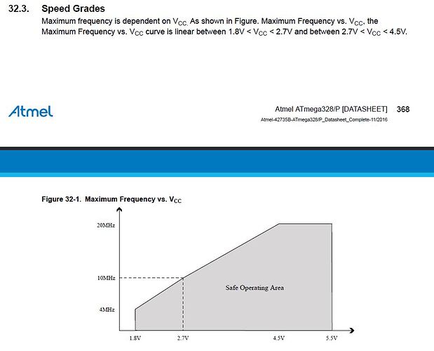

At 16 MHz, Vcc should be >=3.8V per the 328P Speed Grade chart for all functions to be fully compliant (like Serial).
(maybe 3.78V if you do the interpolation math).
