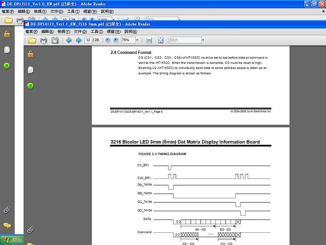

Refer to the snapshot as below of the manual of 3216 and 3208 dot matrix, you can see that it is a totally difference story. I wonder the code on the Arduino playground about HT1632C is suitable for 3208 dot matrix panel or not?

Your display does not have a CLK pin (as the 3216 display has), so the code for 3216 does not apply to your case.
For your 3208 display try using the test code I uploaded here:
http://code.google.com/p/wiseclock2/downloads/detail?name=Test_3208.pde&can=2&q=
The connections from Arduino to the display are as follows (as defined in the code):
#define HT1632_DATA 6 // Data pin (pin 7 of the display)
#define HT1632_WRCLK 7 // Write clock pin (pin 5 of the display)
#define HT1632_CS 8 // CS2 (pin 1 of the display)
Make sure the CS2 switch is ON (and the rest are OFF).

I also download the lib "ht1632.h" and "font3.h". The connection is the same as you quote and the sw 2 (CS2) set to on. Even I comment the line in"Test_3208.pde" as below:
// comment out this line for the 8x32 display;
//#define 16x24
But the 3208 panel is still not work.
3208Panel Decription Arduino
1 CS 8
5 WR 7
7 DATA 6
15 Gnd Gnd
16 +5V +5V
Now I doubt that this panel is out of order. =(
