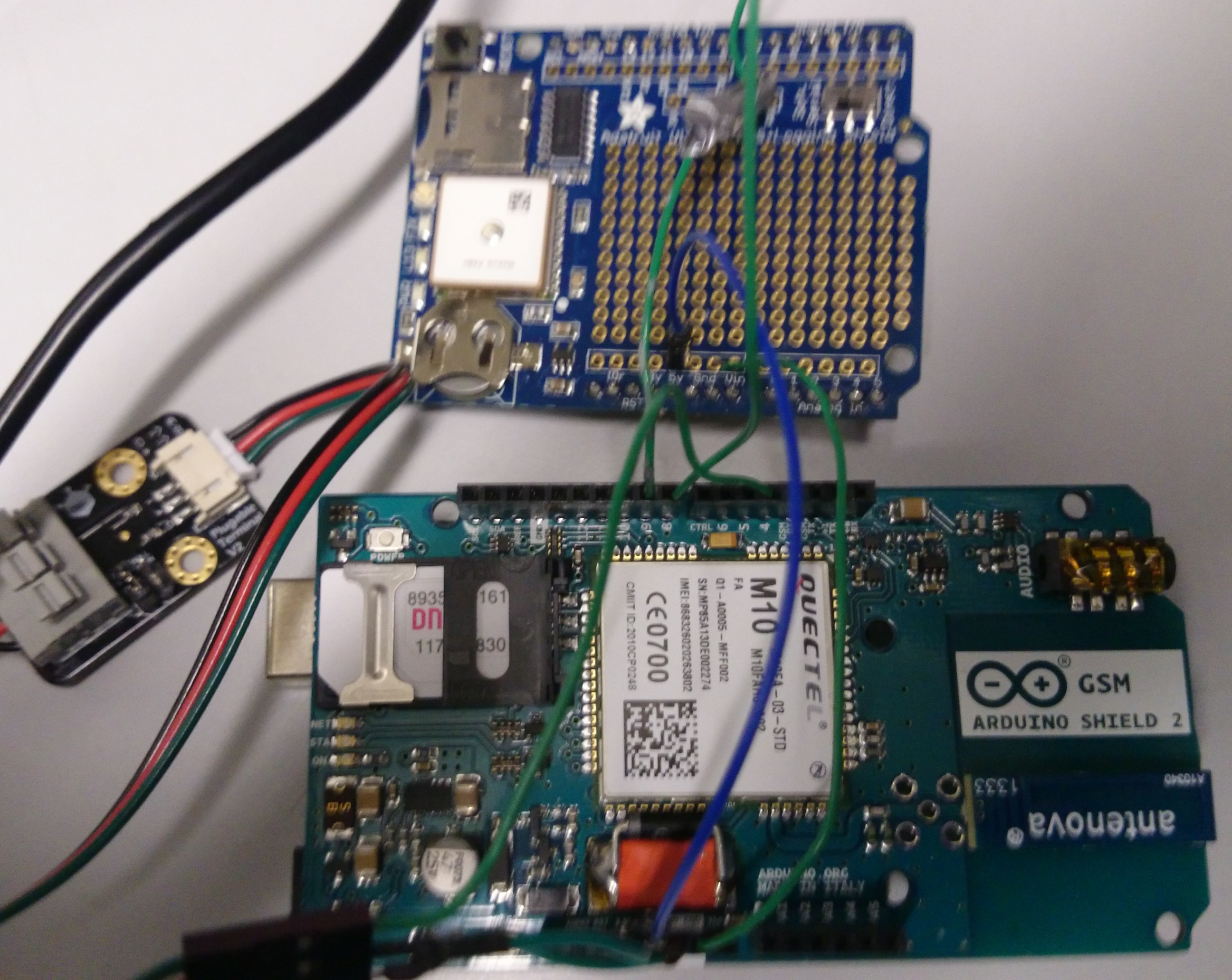

Swimming temperature sensor, Uno, Arduino GSMshield2 (M10), Adafruit GPS, ds18b2
Hello
I am working on a project where I need to take temperature measurements on lake and if my sensor drifts I can locate it. I have really limited knowledge of coding. As I was working on a part where the temperature sensor shows numbers, I learned the difference of int and float numbers.
What I have is a arduino UNO, arduino GSM shield2 (quectel M10), adafruit ultimate gps logger, and a ds18b20 temperature sensor. Data is uploaded to Thingspeak.
I can get temperature data to thingspeak easily with the help of example codes like this:

But as soon as I try to add gps with gsm it breaks. I have tried with libraries softwareserial, adafruitgps, adafruitAltgps, Tinygps++, altsoftserial. As I have looked up from internet I think the Tinygps++ and altsoftserial has been successfull for others for a similar projects. For me when using them I can see that the gps gives right coordinates but my uploading breaks.
This is the code where I join GSM, GPS and Temperature sensor:

Now at this point arduino IDE tells me that:
Low memory available, stability problems may occur.
And in serialmonitor gives me:
Starting Arduino web client.
connecting...
connected
...disconnected        <- This happens when everything is ok also
-127.00     <-not currently temperature sensor connected

Here is how my setup looks like.
Use and anchor , then you don’t need to worry about where it is .
You electronics needs tidying up - I would mount all the parts on a small board.

Thank you for answering.
hammy:
Going to use this on a big lake, so Im afraid that wind and small currents might blow it away. Or if somehow the anchor/anchor line fails I can still find it.
For mounting going to solder some wire directly to gps and connect it directly to arduino. (I have a bad breadboard where arduino pins dont fit nicely so I have done this on table like this)

Thank you Ali Shwaiheen for doing a good guide.
And in the picture there is a wiring setup that we did in testing.
Edit. something went wrong with posting the picture.
You are very welcome MikkoA
MikkoA:
If someone stumbles to this page with same equipment and same problems I found a solution at a guide that was at https://www.instructables.com/id/A-Journey-With-Arduino-GSM-Shield-SMS-Calls-TCP-We/ .
After trying different things with my friend this was a way to make this projects code.
