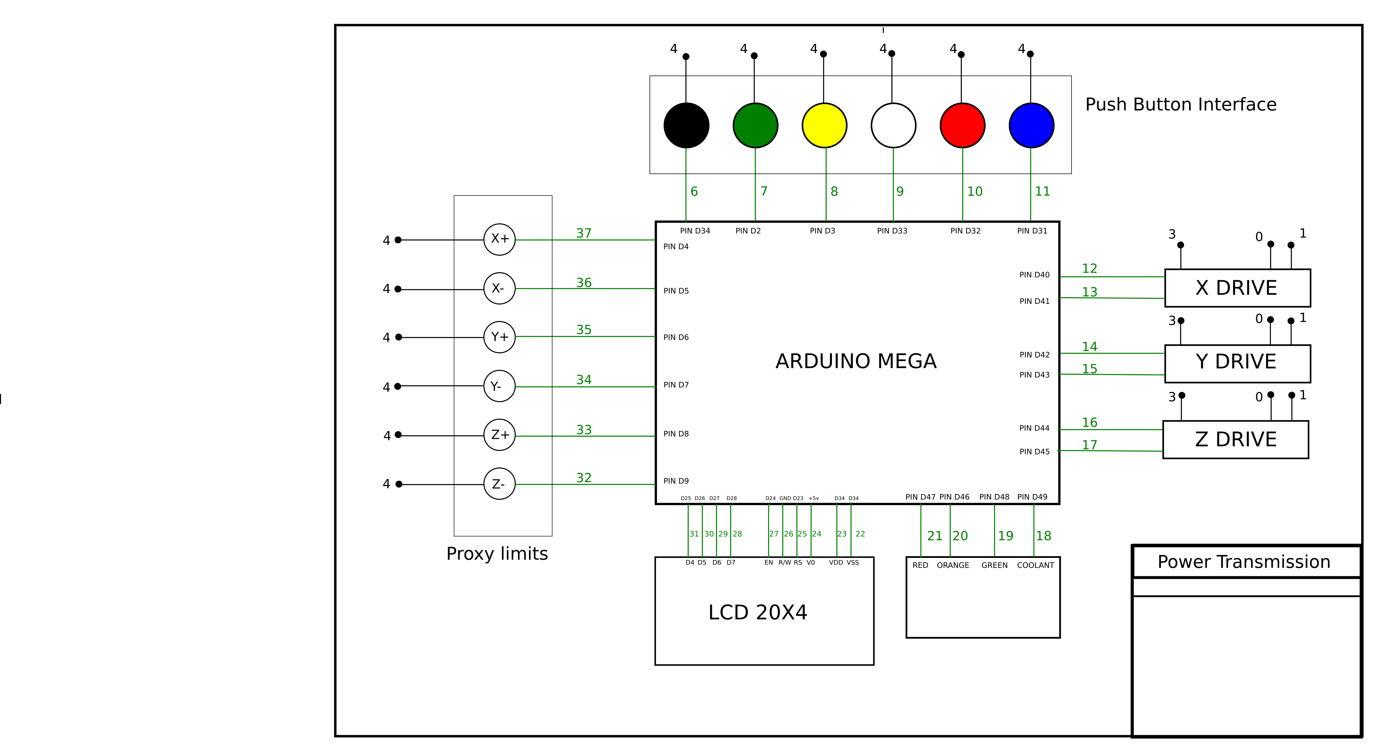

Switching 12VDC LED Indicator lamp through 12VDC relay.
Dear one,
I have setup a system used to indicate the status of running machine with the help of 3 x 12 VDC LED indicator lamps. The challenge that i am facing is when multiple lamps are to be turned on (multiple relays to be triggered), only single lamp (relay) is triggered. I am attaching the circuit diagram of the LED indicator assembly. Kindly let me know what best is to be done to make it working.
Thank you in Advance.
Regards,
Rishi R Soni.
That circuit seems way over-complicated just to switch an led. Why not just use a transistor? If you can switch the ground connection to the 12V led, you just need an ordinary npn transistor and a base series resistor. If you can only switch the 12V connection to the led, you will need a pnp transistor and an npn, plus some resistors.
However, nothing in the circuit you posted would prevent multiple lamps from being switched on. Perhaps you have a bug in your code. Please post that, but read the forum sticky post first to find out how to post code on this forum.

Hi Paul,
Appreciate your quick response,

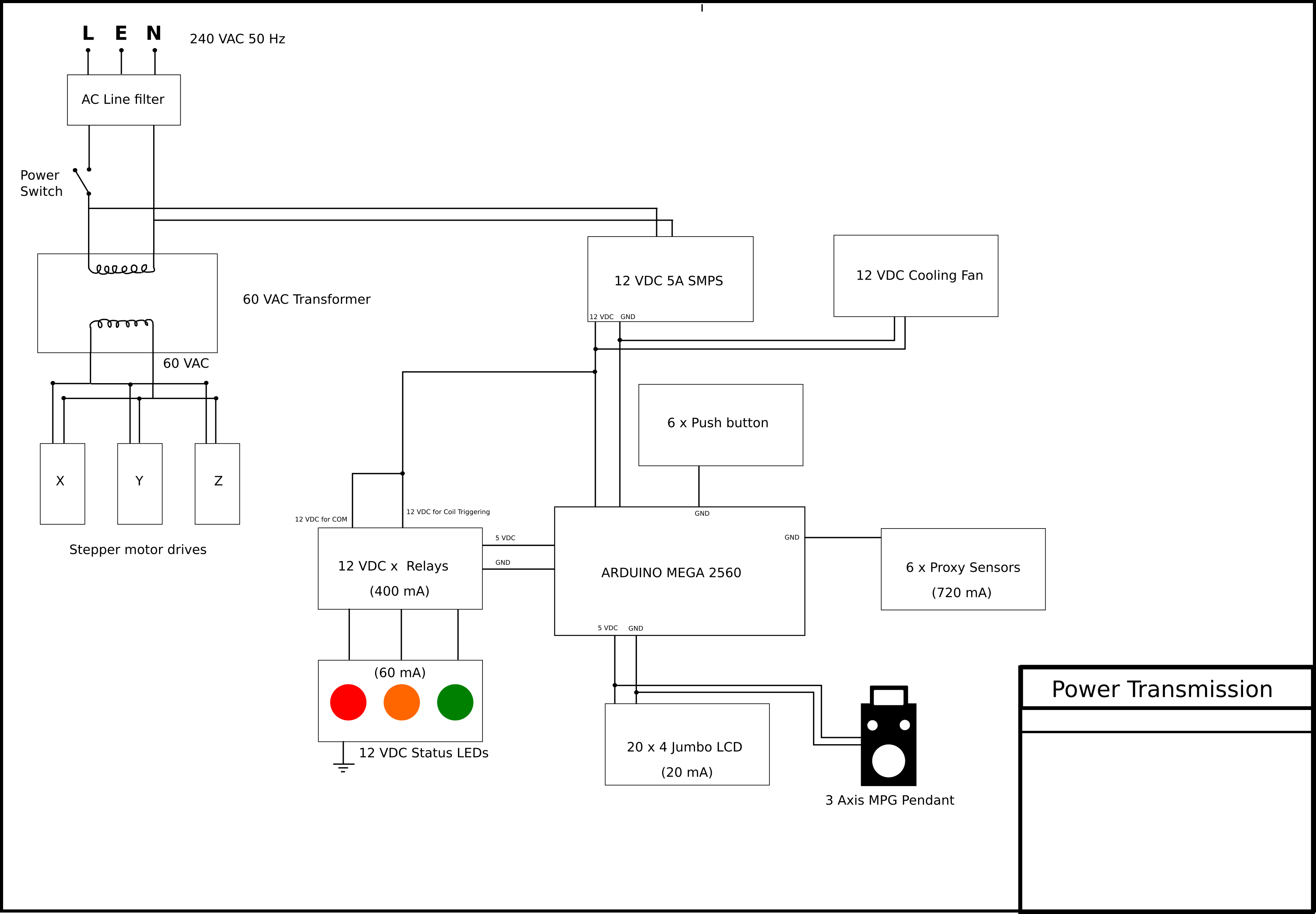

The circuit diagram posted is actually a 12VDC x 4 relay card which is a small part of the larger project. The main project being Surface grinder automator, which has Push buttons, LCD display, Proxy sensors, MPG pendants, stepper motors drives etc. interfaced to the arduino. Now that being said, the code is too lengthy to post on the forum, however the essential codes i will post here.
Also, it is unlikely that there is a bug in the code, as the onboard LEDs for signals on relay card are switching according to the code which means that the code is perfect.
There can be a possibility of incorrect power wiring, hence i am attaching the power wiring and signal transmission diagram along with.

Note that total power draw (supply and pins) from a Mega on a 12volt supply must be < 150mA.
Anything more will overheat the 5volt regulator.
Leo..
rishrsoni:
...the onboard LEDs for signals on relay card are switching according to the code...
So you are saying that the leds on the relay cards do not match the 12V leds? In that case, I agree the code is not the problem.
rishrsoni:
Unfortunately, neither of those are proper schematic diagrams and do not reveal what the problem is.

Dear Wawa,
Good that you mentioned that, it made me to check voltage at input terminals following which the problem was revealed to me.
  1. With all the peripherals connected to arduino, i checked the INPUT voltage which was just 7.6V instead of 13.5V.
  2. One by one removed the peripherals and found the voltage increasing at the input voltage terminals.
  3. Voltage regulator was considerably hot.
  4. Removed all the connecting peripherals to arduino and found the voltage back to 12V.
  5. Now, when all the peripherals are connected, the relay card gets 7.6V instead of 12V which makes it behave strange.
Solution :
Use different power source for the Arduino and other 12V Peripherals.

Assuming your 12V PSU has sufficient capacity, you could use a 12V to 5V DC-DC convertor. These are much more efficient than a regulator and should not get hot. You can power the Mega through its 5V pin.
But also address the matter of those LEDs. Using relays to switch LEDs is crazy inefficient in every way! The relay coil will use more power than the led.
