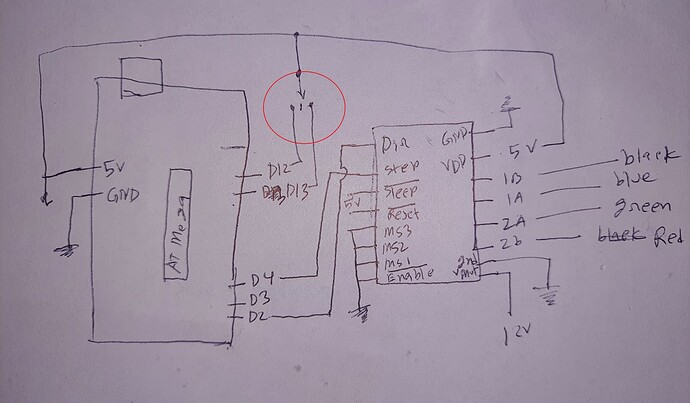

@mridul4808 I think it is time you posted a schematic of your hardware.
It is apparent that word salad is not doing it for you.
Personally I have no idea how anyone can make anything without a schematic.
Code is only half the story. With embedded processors code without a schematic makes no sense at all.
This is what @bobcousins suggested
This is the circuit i was using, , and the switch is in circle.....one in attached with 5V pin of arduino...and other two in D12 and D13. arduino is powered from PC by usb, it was having 5V input.
A switch needs pull up or pull down (resistors).
In your current diagram, D12 and D13 are "floating, and can change between High and Low at will. Either use two 10k resistors from each pin to ground, or..
wire the middle pin of the switch to ground (not 5volt), and use INPUT_PULLUP.
Leo..
I would use the wiring in in post #10, then make input D12 & D13 to be of the INPUT_PULLUP type in your setup function.
This way you are switching the ground, a much better idea than switching the 5V.
Then you will have to change your code to take this into account. That is you will get
Switch to left - D12 = 0, D13 = 1
Switch to center - D12 = 1, D13 = 1
Switch to right - D12 = 1, D13 = 0

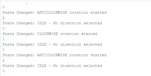

using input pullup now. tried this code :
const int stepPin = 2;
const int dirPin = 4;
const int cwPin = 12;
const int antiCwPin = 13;
int stateFlag = 0;    // Current state
int prevFlag = -1;    // Previous state to detect change
  pinMode(stepPin, OUTPUT);
  pinMode(dirPin, OUTPUT);
  pinMode(cwPin, INPUT_PULLUP);
  pinMode(antiCwPin, INPUT_PULLUP);
  Serial.begin(9600);  // Start Serial communication
  Serial.println("Stepper Motor State Machine Initialized");
  // Read pin states
  bool cwState = digitalRead(cwPin);
  bool antiCwState = digitalRead(antiCwPin);
  // Determine the new state
  if (cwState == HIGH && antiCwState == LOW) {
    stateFlag = 1; // Clockwise
  } else if (antiCwState == HIGH && cwState == LOW) {
    stateFlag = 2; // Anticlockwise
    stateFlag = 0; // Idle
  // Only act if the state has changed
  if (stateFlag != prevFlag) {
    prevFlag = stateFlag; // Update the previous state
    switch (stateFlag) {
      case 1: // Clockwise
        Serial.println("\nState Changed: CLOCKWISE rotation started");
        Serial.print(stateFlag);
        digitalWrite(dirPin, HIGH);
        for (int x = 0; x < 200; x++) {
          digitalWrite(stepPin, HIGH);
          delayMicroseconds(600);
          digitalWrite(stepPin, LOW);
            Serial.println(stateFlag);
      case 2: // Anticlockwise
        Serial.println("\nState Changed: ANTICLOCKWISE rotation started");
        digitalWrite(dirPin, LOW);
      case 0: // Idle
        Serial.println("\nState Changed: IDLE - No direction selected");
  // Small delay to debounce inputs and avoid unnecessary processing
  delay(50);
connected common pin of switch in ground and other two in 12,13.
All seemed okay. but motor stop rotating when it tried to do in both direction. Is it any issue now with delays ?
Are you saying that it does not work at all now?
Well in a way if you ask a motor to rotate both clockwise and anticlockwise at the same time then you should expect it not to move at all?
