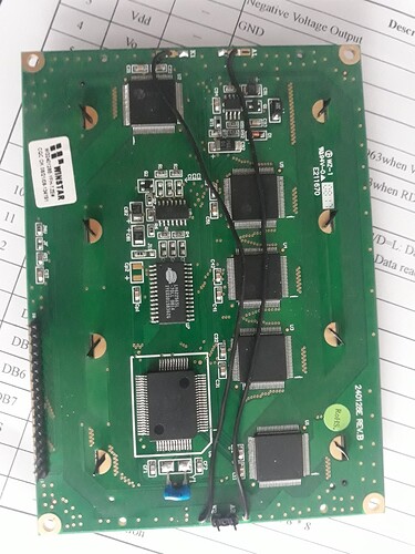

I have two LCDs, RA6963 and T6963. RA6963 connects and works flawlessly with arduino. However, the T6963 is completely unresponsive. I've tried all possible libraries and output methods, but the result is the same (RA6963 works, T6963 doesn't). Datasheets are exactly the same for both displays. I will be grateful for your help.

Provide links to the site you bought the displays. Provide pictures of the backside of both displays.
It could be as simple as different backlight control.

Which one? using read ID method? Or do you mean to say something else?
RA6963:
WG240128E-TFH-VZ.pdf (804.7 KB)
T6963:
MGLS240128T-07.pdf (112.4 KB)

I found a solution. The T6963 is an older model, so it required more current
Thanks.
NOTE: If you have the same problem, you can try doing a C/D inversion (It's different on some displays)
