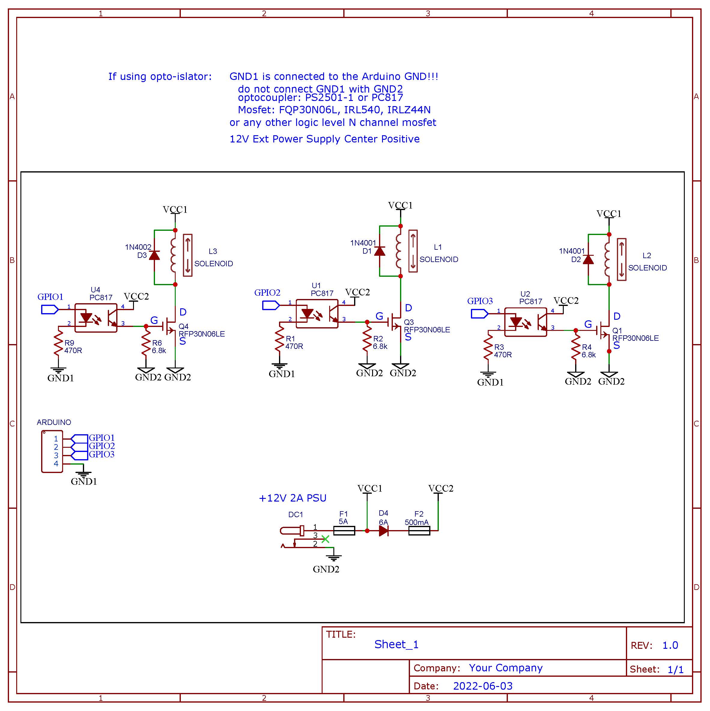

Is it possible to use PC814 AC optocoupler instead of PC817 with a DC signal from an arduino?
I'm looking for 1 channel optocoupler from TaydaElectronics and the pc814 is the onlyone I have found
Yes.
But what is the circuit you want to use it in? They both only have a 50mA maximum current.
general circuit like that one for driving a mosfet to drive a solenoid/motor etc
Why do you think you need an opto isolator to do this job? I can't see the point in it myself unless GND2 is floating with respect to GND1.
for extra safety for preventing current to flow from the solenoids back to the arduino(?)
using the optocoupler will isolate the arduino from the solenoid completely isn't it?
Why would it do that?
Is Vcc1 connected in any way to a supply that powers anything else? If it is there is zero point in having an isolated ground, because there wouldn't be one.
You would need to show the whole circuit to make sure, not just an arbitrary piece of schematic. In the past you have not been good at supplying schematics that show the whole of the picture.
What is the application?
What environment will your project be working in?
It is not connecting to anything else. only for one of the solenoid terminals and to the collector leg of the optocoupler.
I don't have anything in praticular, I wanted to build a general purpose circuit to drive solenoids or dc motors using an arduino..
driving solenoid or dc motors
arduino (if I understand your question)
