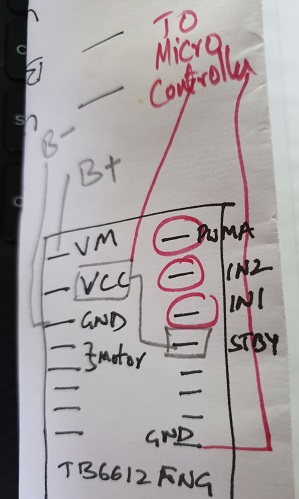

But I do not know how to test using multimeter. If I supply 3.7v to VM, should I get something in VCC ?
can I connect as in the picture? My micro controller is Wemos D1 v3.0
Surely no. Vcc is for the 5 volt parts an Vm is for the motors. 2 separate supplies are needed.

Sorry for not asking properly. I now have downloaded Fritzing and designed the schematic
The grey wire is my grey area. I would like to know, if I can connect to 3v3 or 5v pin.
1 motor, 1 x 18650.
If I need to connect direct from battery to 5v Wemos [ and also to VM of driver] , please let me know
Grey is Motor driver's VCC
Please ignore the orange wires...I will use a pwm pin and 2 digital pins
VCC and Standby are connected. Is that right or not...I dont know

Create a proper wiring diagram showing both connection points and their symbols. Those coloured lines criss crossing are no good. We will not sit and compare circuit pin numbers to where the lines start and end.

And it's really pretty simple...
LiPo battery goes to VM of the TB6612FNG to power the motor and Vin of the WeMOS.
3.3V of the WeMOS goes to the Vcc pin of the TB6612FNG, powering the logic part of it.
Remember to connect all the grounds of the TB6612FNG with each other and the WeMOS.
By the way, don't waste your time on Fritzing. You should by now know why. Get real circuit drawing software, or if you're not willing to go through the learning curve (which is pretty steep) grab a piece of paper and a pencil. That already gives generally far more useful results than Fritzing.

STBY pin has to be connected to an output (or pulled up to Vcc).
Vcc is not connected to any power source - connect it to the 3.3V pin of the WeMOS.
Why don't you follow one of the many online tutorials, like this one from SparkFun? Except for them using a single power supply it's basically the same as what you're trying to do.
