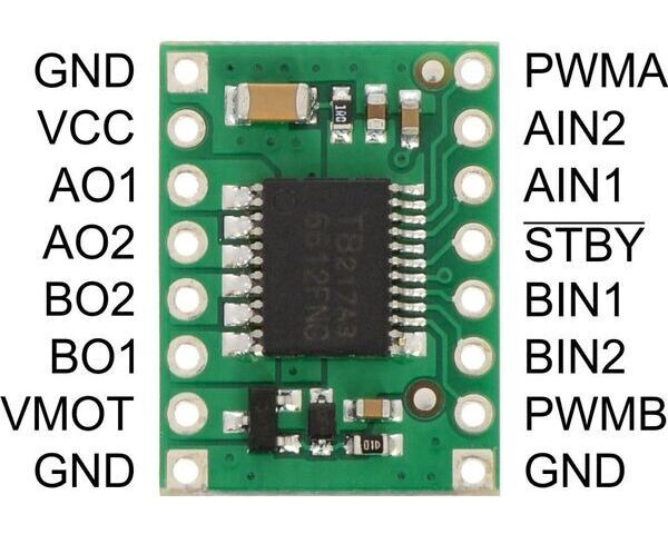

Hello, I am extremely new to Arduino; this is the first time I am using one. I am using the Uno R3. I want to control the speed of a DC motor through the arduino, but it is not working for some reason. I am using the TB6612FNG motor driver from Pololu. Here is its pinout.
pinout

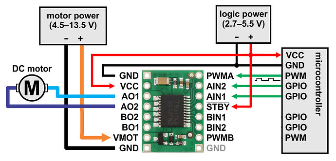

My circuit looks like this, with the red motor driver in the middle being the TB6612FNG:
I am using a 9 volt battery.

This type of battery is not recommended for driving an motor.
Is your motor a 9V motor?
Where does the Uno get it's power?
What type of battery should I use then? Do I need another battery for the logic power?
See post #4
The current motor is a 3V motor, you are right.
I switched to one rated for "1.5-12V", and tested the circuit again, but it is still not working.
I believe that the Uno gets its power from the external 9V battery, but I am not sure. Can you please help me?
Not according to your wiring diagram. Connect the Uno to your computer and try again
I am unsure what you mean by connecting the Uno to my computer. I used an AB USB cable to connect the USB connector on the arduino to a USB port on my laptop, and then uploaded the sketch.
According to your diagram the Uno has NO power. Connect it to your computer in order to supply power to the UNO, otherwise it will not work.
