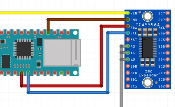

Here is what my layout looks like exactly:
  • I'm using a Nano 3.3 IoT
Why is it finding 2 addresses on the ports that have nothing connected to them?
Am I missing something fundamental here?
Any help is appreciated as when I connect I2C components to the Multiplexer it is not working correctly, so I figured I would start back from the basics, but clearly I don't have that figured out yet.

Do you have the mandatory 4K7 pull-ups on the I2C lines ?
They could be on the modules, but unlikely.
I dont have any I2C components connected to TCA9548A.
For the TCA itself Adafruit doesnt specify requiring any on their installation guide, and every other circuit ive seen working doesnt have any between the TCA and Arduino.
Are we saying I need one on the TCA to Arduino I2c bus?

That would be correct. If your device is on the Arduino side of the multiplexer, then it will always be seen during the I2C scan regardless of the multiplexer settings.
I will try with pull up resistors and see, but ive never seen them on any other application.
Ok, thanks for the explanation.
Do you know what the other 2 addresses could be that it is finding?
It is finding these addresses when no I2C device other than the TCA is connected.
Yes. They are the ECC608A Authenticator chip (0x60) and the LSM6D IMU (0x68). These are both I2C devices and they are on your Nano 33 IoT board.
Thank you, that helps me a lot!
So it appears that without components on the TCA it is working correctly; maybe now i need to figure out why it doesnt when components are connected to it.
