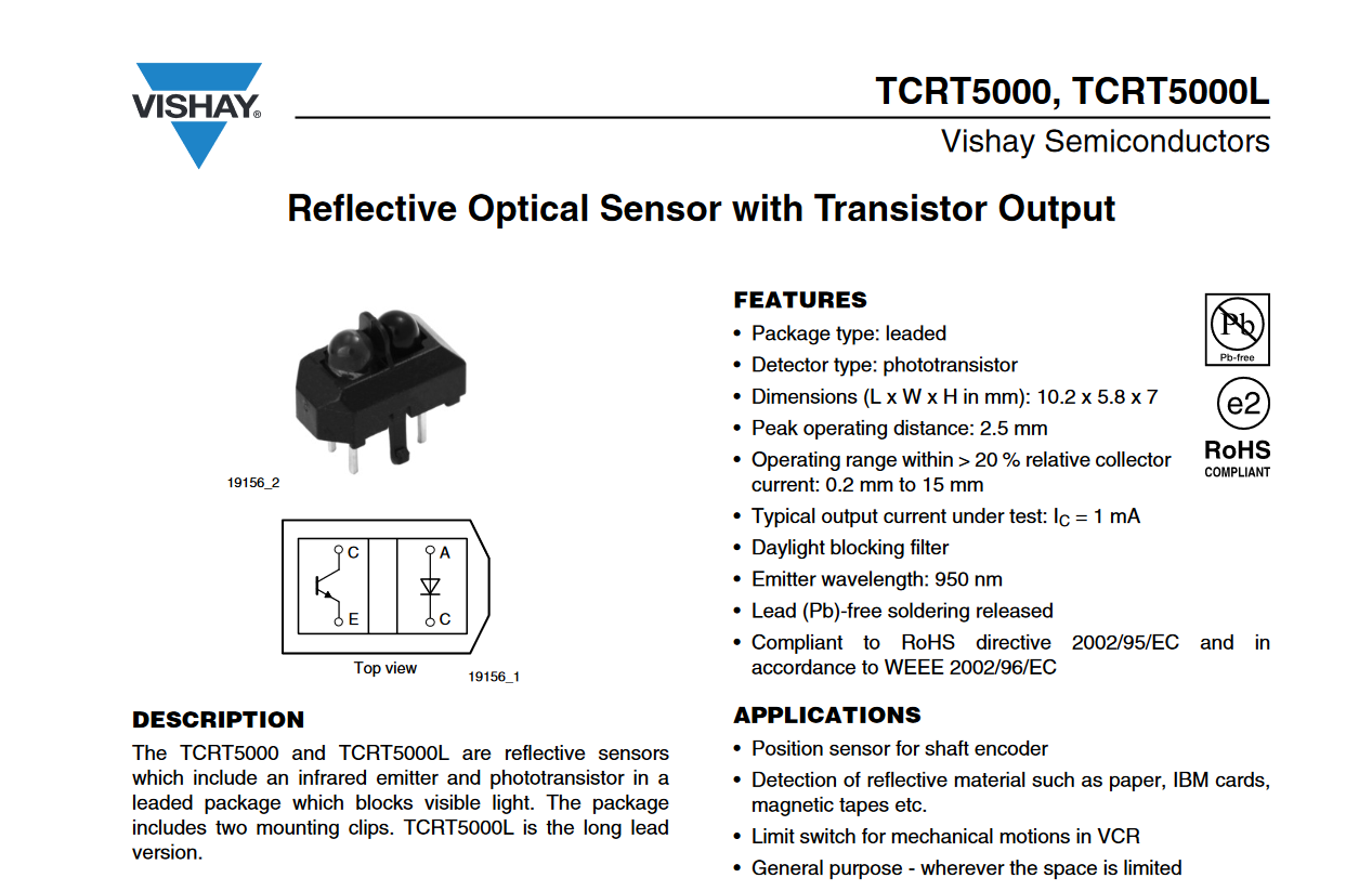

My TCRT5000 is connected as shown in the attachment.
I am testing it in a bright room.
I observe the values of a, b and c on the Serial Ploter of the IDE, see picture plot.png.
Left and Right: NO Hand infront of Senosr
Middle: Hand infront of Sensor
  • Why is it that the "noise" is higher than the "noise + signal" when nothing is infront of the sensor? Shouldn't it be the other way around, because the sketch takes care of that?
  • When I shine a light on the sensor the "noise" value gets higher but the "noise + signal" stays at the same value, Why?
  • The TCRT5000 datasheet mentions a "Daylight blocking filter", what does it block? Is that the reason the "noise + signal" value stays the same even when a bright light is shined on the sensor?
Thank you
In that picture you have a connection vom GND to LED_C, from Vcc to LED_A over 100Ω resistor and from Trans_C to a GPIO (I guess that should be D8). I cannot see the 5kΩ resistor from Vcc to Trans_C and Trans_E is not connected to GND as the instructable suggested. You also have no connection to A0 so you probably measure a floating pin which might result in about the picture you posted in plot.png.
If the hardware is connected wrongly I would not expect correct behavior. Dito for 2.
No, that means that the sensor has a filter so that the photo transistor ignores most of the wavelengths of visible light. Depending on the type of your "bright light" it might include infrared wavelengths or just emit visible light, you didn't specify what exactly you used.
