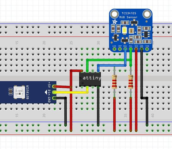

TCS3472 color sensor on ATTiny85 does not initialise
link to breadboard picture on github
I am trying to transfer this project with TCS3472 color sensor from Arduino Nano to ATTiny85. At first I encountered som problems compiling the project because the "Adafruit_TCS34725.h" is using the arduino wire library, but finally succeeded compiling it successfull by using ATTinycore with options Board: ATTiny/25/45/85(no bootloader) and Programmer: Arduino as ISP. The next problem is that the TCS3472 somehow does not initialise. I use i2c connections that I used in other projects: SCL pin4 and SDA pin0. Tried using TinyWireM.h and wire.h which both compiles OK. Any suggestions? (beginner)

With an I2C sensor, the very first thing to do is to test the I2C connection by loading and running the I2C address scanner program, and make sure that it recognizes the sensor with the expected address.
If not, check connections, and that you have the required pullup resistors on the I2C lines.
Somehow the i2c device doesnot showup when connected to the ATTiny.
I tried this:
  • wrote a i2c scanner that displays the found address binairy on the led strip but it finds nothing
  • checked the ATTiny is running at 16MHz : Yes
  • Wire.setClock() to set the I2C clock speed to 100kHz and 10kHz, which should be compatible with the ATTiny85.
  • two pullups of 10k to sda and scl
  • 3.3v and 5v
  • compiled succesfully with wire.h or TinyWireM.h
does "i2c scanner" sketch find TCS3472 on other Arduino?
Actually it didn't and I forgot to test it on Arduino because the sensor is working there. I changed the scanner (forgot Wire.begin():wink: and now it works on arduino but still finds nothing on ATTiny i2c.
I did not succeed in changing the clock speed to 100.000. My code is on Git chameleon/MyBot4.8.ino at main · gtmans/chameleon · GitHub
There are likely to be one or more errors in the ATtiny code and/or wiring.
Post the required details, as outlined in the "How to get the best out of this forum" post, and perhaps someone can help.

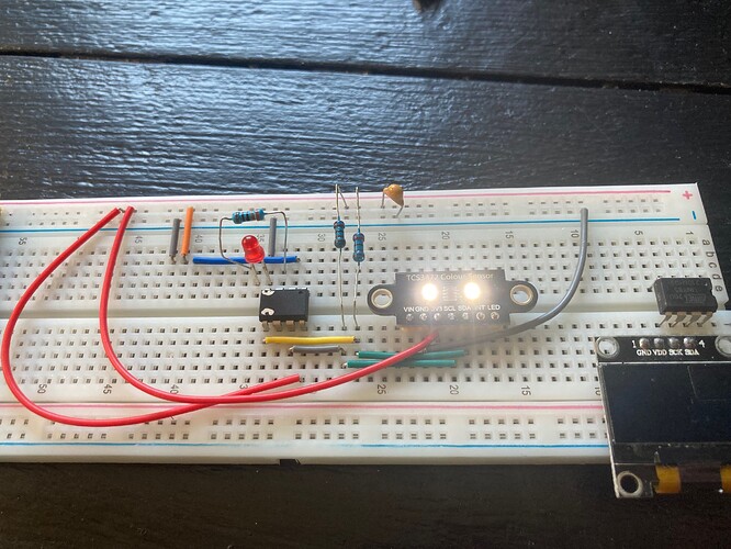

Neither the Fritzing diagram, nor the photo, show the required 100 nF decoupling capacitor across the ATTiny power and ground connections.
The breadboard PHOTO does not show the required pullup resistors on SDA and SCL. Please explain.
Does the ATtiny run any program? Add an LED plus current limiting resistor, and test it with the Blink program.
Sorry. The breadboard PHOTO was taken earlier. First I added 10K pullups, later replaced them by 2k2 as on the fritzing sceme
Yes the ATTiny runs this and other programs. This running program does a portscan and displays the binairy addresses it scans on the Neopixel strip. After that it diplays a specific color when no mudule was found.
When I replace the sensor by another i2c device it finds the address straight away.
I will try to get that capacitor. Thx for the tip.
To test a new device, always start with the minimum possible example code.
For example, the neopixel library turns off interrupts, required for I2C communications.
So back to the minimum. Written an i2c scan that only uses one led. When it blinks 5 times it found a device on i2c. It does not find the TCS3472 but does find (when connected instead of TCS-module) other i2c devices like .96 oled screen
new i2c scanner for one led:
// i2c_scanner ATTiny85 led debug blinks 5 times when i2c device found
// using  ATTinycore (which supports Wire.h)
// Board: ATTiny/25/45/85(no bootloader)
// Programmer: Arduino as ISP
// ATTiny85 running at 16MHz(PLL) and burned bootloader for 16MHz
#include <TinyWireM.h>          // I2C Master lib for ATTinys which use USI
#include <avr/power.h>          // Required for 16 MHz Adafruit Trinket
#include "Adafruit_TCS34725.h"
#define   TST_LED    4          // PB4 pin to which the led is attached
Adafruit_TCS34725 tcs = Adafruit_TCS34725(TCS34725_INTEGRATIONTIME_50MS, TCS34725_GAIN_4X);//https://learn.adafruit.com/adafruit-color-sensors/library-reference
   pinMode                   (TST_LED, OUTPUT);
   for (int i=0;i<3;i++)     {digitalWrite(TST_LED, HIGH);delay(500);digitalWrite(TST_LED, LOW);delay(500);}
                             delay(1000); // blink 3 times and wait a second
   TinyWireM.begin();
   scani2c();                 // (3 initial+) 5 blinks=found device 10 blinks=error 15 blinks=no deviced found
   if (tcs.begin()) {
    digitalWrite(TST_LED, HIGH);// led on  means found a device  on i2c
    digitalWrite(TST_LED, LOW);// led off means no device found on i2c
void loop() {}
void scani2c() {
  int nDevices=0;
  for (byte address = 1; address < 127; ++address) {
    // The i2c_scanner uses the return value of
    // the Wire.endTransmission to see if
    // a device did acknowledge to the address.
    TinyWireM.beginTransmission(address);
    byte error = TinyWireM.endTransmission();
    if (error == 0) {
      // I2C device found at address 0x
      for (int i=0;i<5;i++)   {digitalWrite(TST_LED, HIGH);delay(500);digitalWrite(TST_LED, LOW);delay(500);}
                              delay(1000); // blink 5 times and wait a second
      nDevices++;
    } else if (error == 4) {
      for (int i=0;i<10;i++)  {digitalWrite(TST_LED, HIGH);delay(500);digitalWrite(TST_LED, LOW);delay(500);}
                              delay(1000); // blink 10 times and wait a second
  if (nDevices == 0) {
      for (int i=0;i<15;i++)  {digitalWrite(TST_LED, HIGH);delay(500);digitalWrite(TST_LED, LOW);delay(500);}
                              delay(1000); // blink 15 times and wait a second
result
I could not get the TCS3472 color sensor to work with ATTiny85. So I switched to Seeeduino Xiao and it works like a charm. This post can be closed, thanks for your help. More at https://github.com/gtmans/chameleon
