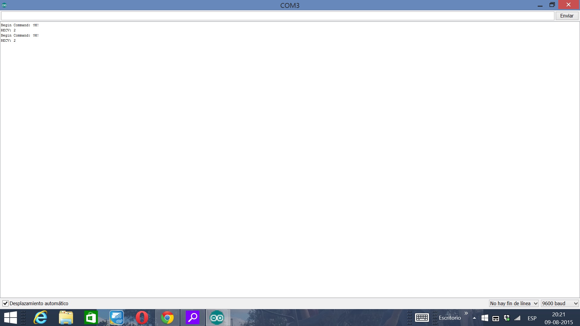

Software Serial didnt work, so now i connected the Shield Ground wire to Arduino's G and ignored de Rx wire using Tx as the SDI data line.
CS655 Function Arduino Power Source
Green TxD pin 2 -
Red Power - 12V
Black G Ref. - G
Clear G Shield G -
Orange RxD - -
Now im getting a response using the same code as above (RECV: 2). As the code says is the value of the maximum wait before the measurement is ready. I'm not sure how to proceed though.

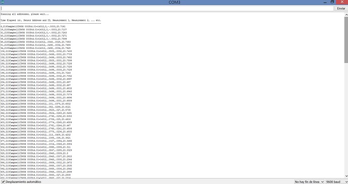

So finally i succeeded by using another library https://github.com/StroudCenter/Arduino-SDI-12 and wiring ref. ground to power source and shield ground to arduino ground (just like the schematic above). I used the simple logger example code from the library.
