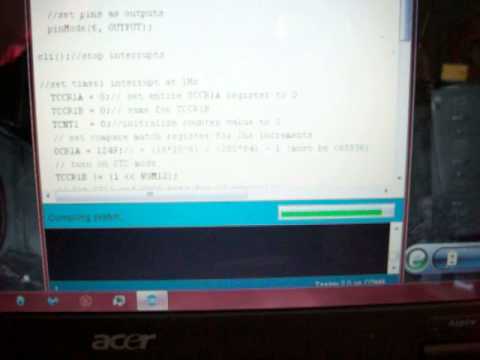

I'm having a really confusing time right now.
I've never had any problems with the loader, in fact I've been using it for my Teensy++ 2.0 for months. I plugged in the 2.0's I bought a week ago and now the loader doesn't work for either. Below is a video with this behavior. http://www.youtube.com/watch?v=TeqohEXw2_o&feature=youtu.be
The IDE compiles for the Teensy 2.0, but I have to rummage through my temp folder to find the compiled hex manually with the loader.
To try and make sure it wasn't just the Arduino install, I now have 1.03, 1.53, and 1.02 (my original install) and I've installed the Teensyduino package on all of them.
Any ideas would be greatly appreciated.

The video in my first post shows what happens: 1) it compiles 2) creates a file in my temp directory 3) opens the Teensy Loader program (if it isn't open already) 4) error shows that asks if the loader is open
I can: 1) Program every board I have 2) Compile for every board 3) Load any program I have

Win7 Pro x86 on laptop w/ Core2Duo 2GB RAM, using Windows Firewall. I unzipped the Arduino software, installed Teensyduino on the versions I have. If you want to look at my config files lemme know which ones to post.
Here is the verbose output of the loader. 22:29:56: Verbose Info event 22:30:24: remote connection opened 22:30:25: remote connection opened 22:30:25: remote connection opened 22:30:26: remote connection opened 22:30:26: remote connection opened 22:30:26: remote connection opened 22:30:27: remote connection opened 22:30:27: remote connection opened 22:30:27: remote connection opened 22:30:28: remote connection opened 22:30:28: remote connection opened 22:30:28: remote connection opened 22:30:29: remote connection opened 22:30:29: remote connection opened 22:30:29: remote connection opened 22:30:30: remote connection opened 22:30:30: remote connection opened 22:30:31: remote connection opened 22:30:31: remote connection opened 22:30:31: remote connection opened 22:30:32: remote connection opened 22:30:32: remote connection closed 22:30:32: remote connection closed 22:30:32: remote connection closed 22:30:32: remote connection closed 22:30:32: remote connection closed 22:30:32: remote connection closed 22:30:32: remote connection closed 22:30:32: remote connection closed 22:30:32: remote connection closed 22:30:32: remote connection closed 22:30:32: remote connection closed 22:30:32: remote connection closed 22:30:32: remote connection closed 22:30:32: remote connection closed 22:30:32: remote connection closed 22:30:32: remote connection closed 22:30:32: remote connection closed 22:30:32: remote connection closed 22:30:32: remote connection closed 22:30:32: remote connection closed 22:30:32: remote connection closed
So it opens crap tons of connections for some reason.

I found the program that was causing the problem. It didn't like some of Auslogics BoostSpeed's settings.
