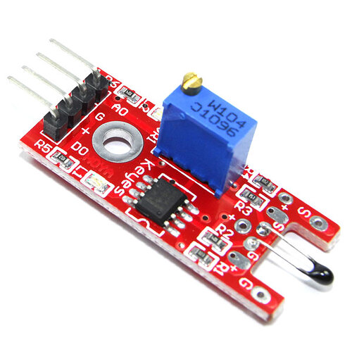

Hello, how can i make script for this module KY-028 digital temperature sensor to show temperature in °C. Please help me i need it im beginner in arduino.

You can't measure temperature with a KY-028 module. The pot sets a temperature at which the digital output switches from LOW to HIGH. You want a KY-013 module for reading the temperature. Even better is a DS18B20 (OneWire interface) or a TMP36 (analog interface)
The analog interface returns a numeric value that depends on the temperature and the potentiometer's position. Since analog output pin is directly connected to the potentiometer it isn't possible to use the Steinhart-Hart equation to calculate the temperature as as we did with the KY-013, we can only use this value to measure relative changes in temperature.
