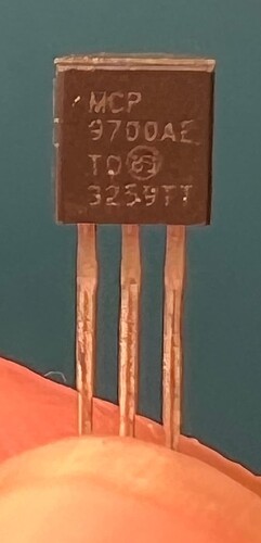

I am trying to do simple temp temperature tool as it is described in Project 3 (Arduino Starter Pack).
I set everything correctly but getting random number from 0 to 70. What can be wrong?

That sensor should put out 0.5V at 0C, increasing by 0.01V for each degree C increase in temperature. So that fact that your readings are all clustering around 0.5V is troubling unless it's in a fridge.
Things to check:
  1. What do you have the ground and Vdd pins of the sensor hooked up to?
  2. Is Vout in fact connected to A0?
  3. If you put a meter on Vout, what voltage are you seeing?
  4. Also, check what voltage you're actually getting on the 5V line and using that value in your calculations rather than assuming 5.0V.
Which Arduino are you using and what, exactly, is the "Arduino Starter Pack"?
A web search does not turn up a product matching that exact name, so please post a link to it.
Yes, I am using Arduino Starter Pack and its components
I use the simplest connection as you can see on attached photos. Vout to A0.
You have the sensor's Vdd pin hooked up to I/O pin #10, which is not referenced in any way in your sketch. So it defaults to an input pin, which is not capable of supplying power to the sensor.
Perhaps try it with the sensor's Vdd pin connected to a 5V pin on the Arduino.
Hmm, you are right, again, thank you so much! Whenever I started using 5V analogue pin, I was getting right temperature value! :partying_face:
What is still weird is that when I tried that variant with #10 digital pin and activate it via:
pinMode(10,OUTPUT);
digitalWrite(10, HIGH);
so I still got wrong temperature values. It seems that this way thought digital pin does not work at all. What do you think?

When I use #10 digital pin to power up my circuit, I am getting higher numbers around +10C see:

If I use 4.5 V instead of 5 V in your formula I get 27.7ÂșC for a sensor value of 177. Try measuring what the D10 High output voltage actually is and using that in your equation.
Never mind. That doesn't really make any sense since D10 is not the ADC reference and the sensor output is not proportional to Vdd.
I don't know why powering the sensor with pin 10 is not giving the same result as using the 5V pin. The sensor needs a supply of between 2.3V and 5.5V. If it gets that, it should work and the readings should be the same for any input voltage.
The sensor's operating current is a few microamps. The Arduino pin could probably provide enough current for 1000 of these sensors at the same time.
Try connecting pin 10 to A0, instead of the sensor output. What voltage does it report? (Ignore the temperature reading, that will be 100C+).
