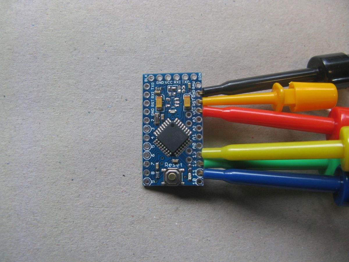

Use test clips;
I am modifing the Pro Minis by changing the 3V3 regulator for a low current on and setting the BOD fuse to 1.8V.
