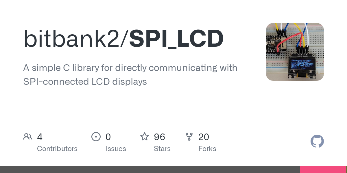

I support this display with my SPI_LCD library
