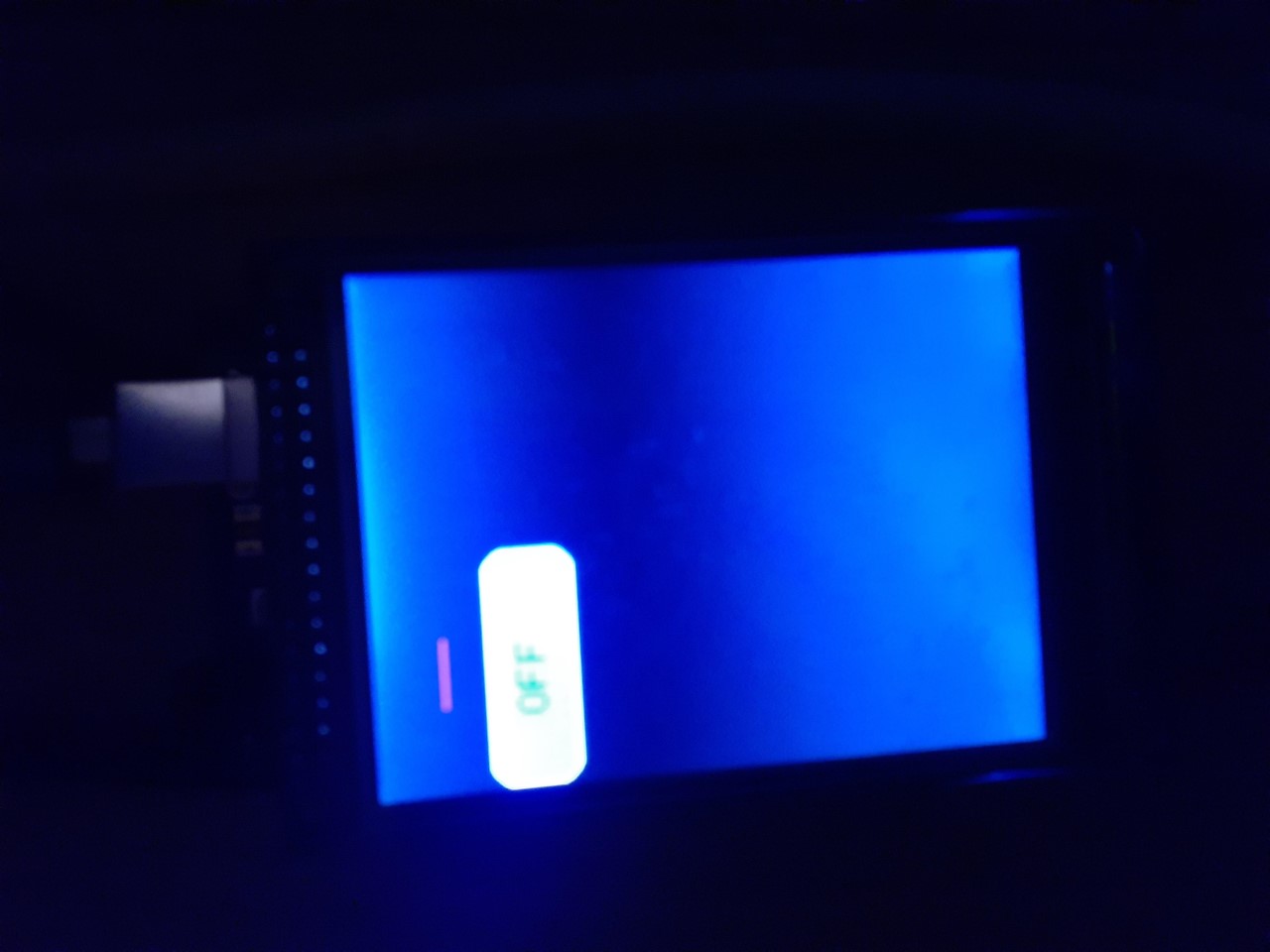

Thanks David,
I followed your suggestion and it seems better, not perfect but an improvement.
Now is using the full screen, placement is a bit off still.
I edited mcufriend_shield.h: #define USE_SPECIAL
Edit mcufriend_special.h #define USE_MEGA_16BIT_SHIELD
I didn't do minor one-time edit of MCUFRIEND_kbv.cpp - was that for UNO only? If not what is the Edit please?
Example was button simple, I changed it a little though.
And I changed setup to:
void setup(void)
uint16_t ID = tft.readID();
Serial.print("TFT ID = 0x");
Serial.println(ID, HEX);
Serial.println("Calibrate for your Touch Panel");
if (ID == 0xD3D3) ID = 0x9486; // write-only shield
tft.begin(ID);
tft.begin(0x9329);
tft.setRotation(0); //PORTRAIT
tft.fillScreen(BLACK);
on_btn.initButton(&tft, 60, 200, 100, 40, WHITE, CYAN, BLACK, "ON", 2);
off_btn.initButton(&tft, 180, 200, 100, 40, WHITE, CYAN, BLACK, "OFF", 2);
on_btn.drawButton(false);
off_btn.drawButton(false);
tft.fillRect(40, 80, 160, 80, RED);
The "minor edit" was for the Jaycar display. It uses a "less common" UC8230 controller e.g.
UC8230   240x320  ID=0x8230 #define SUPPORT_8230
The good news is that your display is not dead.
Please run graphictest_kbv.ino (with the tft.begin(0x9329); statement )
Either take notes on paper. Or post a video. Or a few photos of Penguin screens.
David.
