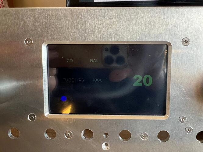

TFT display conflict with Rotary Encoder in ESP32 project
Hi Guys
I have problem with Rotary Encoder and TFT display in my ESP32 project.
I have tested this code with only TFT display connected with ESP32, it works fine.

And then I connected Rotary Encoder with ESP32, with the Pins below
#define ENC_A 9
#define ENC_B 10
#define MaxVolume 100
#define MinVolume 0
volatile int counter = 0;
I used GPIO9 for PinA and GPIO 10 for PinB of Rotary Encoder.
This is the schematic of Rotary Encoder is below
And I tested Rotary Encoder alone, it works fine

When upload the program to ESP32, the screen shows correctly, but if I turned the Rotary Encode. The TFT screen will turn to Black and shows nothing, and will not show anything anymore.
Found the problem. The Pins used for Rotary Encoder
and the Pins used for TFT screen
GPIO9 and GPIO10 are conflict
I changed GPIO6 for PinA and GPIO13 for PinB of Rotary Encoder, everything works fine now. :grinning:
