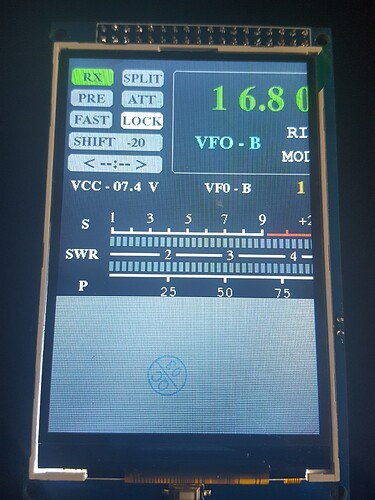

i have a sketch file for a control board for a synthesizer (Si5351a) it uses a mega2560 and a 3.2" tft display
which is supposed to display in lanscape mode.
i have loaded it into the mega2560 and it only showes in portate mode.
this one is the first time i used the sketch
this on is after i chenge the tft driver
sorry forgot to say that this is a 3.5" display

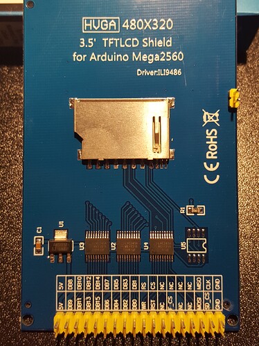

That is a Shield designed for Mega2560. It even has the information printed on the pcb.
Install UTFT.h library (from rinkydink)
Run the examples e.g.
C:\Users\David Prentice\Documents\Arduino\libraries\UTFT\examples\Arduino (AVR)\UTFT_Demo_480x320\UTFT_Demo_480x320.ino
Edit the constructor e.g from this:
// Remember to change the model parameter to suit your display module!
UTFT myGLCD(CTE32HR,38,39,40,41);
to this:
UTFT myGLCD(ILI9486, 38, 39, 40, 41);
You will need to do the same edit on every example. Report any problems.

From your User_Setup.h:
// Define ONE driver, either HX8357B, HX8357C, ILI9481 or ILI9486
//#define HX8357B
//#define HX8357C
#define ILI9481
//#define ILI9486
Your photo in #3 says ILI9486. Change the define to ILI9486.
Don't worry about inverted colours. We can fix that for you. Just say whether TFT_BLACK shows as white. Or TFT_GREEN shows as magenta. Or TFT_BLUE shows as yellow.
David.

yes i have seen that, and Changed the define to ILI9486.
but i still have same problem with display not going landscape
most ot them UTFT examples worked ok and did landscape
byte multiplier;
byte Screen_rotation(1); // have tried 0 2 3
byte Screen_negative;
byte Grey_color_correction;
byte Syn_config;
int TFT_GREY1 = 0x8410 ;  //#define TFT_GREY1 0x8410 // New colour  // HERE WE CORRECT THE GRAY COLOR !!!!! 11 0x8410 - GREEN LABEL 0x39E7 - YELLOW LABEL
byte flag_plus_or_minus_IF;
byte number_of_channels = 9;
This is part of code from my sketch, as you can see i have tried to change Screen rotation but with no effect.
Is this the part of code i should be looking at ?
#include <TFT_HX8357.h> // Hardware-specific library
TFT_HX8357 tft = TFT_HX8357();       // Invoke custom library
Thanks for your time
