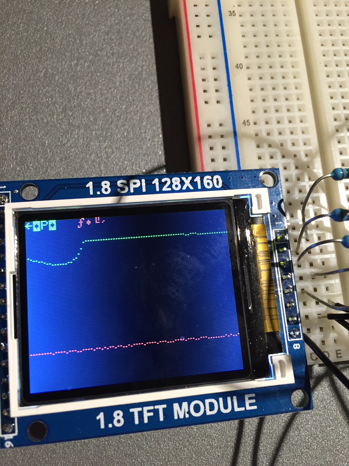

Hello!
Im trying to make a scrolling graph displaying the humidity and temp.
But the string displaying the temp and humidity is not displaying the proper chars.
Can anyone help me?
Please see the attached image.
Edit: The graph is displayed incorrectly. Every other spot was skipped. Could this have with the other display faults to do?

Hi
There could be serveral reasons:
  • The small upper circle is not there in the font
  • There is a confusion between UTF8 encoding (Arduino IDE encodes with UTF8, but UTF8 is not suported by print)
  • It is not clear what the String class does with "+ (char)value +"
My suggestions are:
  • Do not use "String" class. I am sure you can use .print() for your output only
  • Prefer "\x" instead of (char).
  • Ensure, that the font includes the upper circle (degree symbol). If this is not there in the Adafruit lib, consider ucglib (installable from the library manager of the IDE). All "full" fonts from ucglib should include the degree symbol. See here for example.
Oliver
Edit: From looking at the ucglib font map, i just noticed, that the degree symbol is at positon 176, whereas the symbol at 247 is indeed the division symbol which is also shown on you attached picture. So maybe the glyph code is wrong in your code.

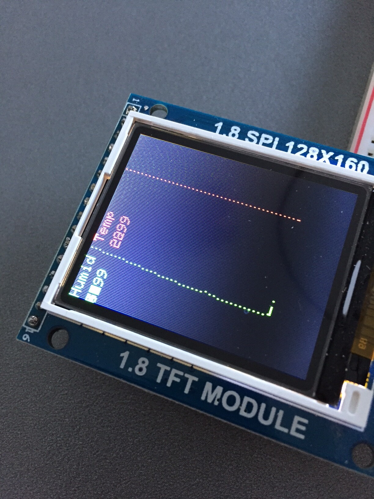

Thanks for the reply!!!
Som changes.... Please look at the TFTscreen.print
Still get the corrupt chars just trying to print an int value.
Look at the attached picture

This do not work either
Solved...
For some reason.. When I add TFTscreen.fillScreen(0x0000); every loop in main loop then the text displays properly...
the refresh time for the code will be set to about 1 hour so it will work. Even if its ugly....
