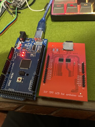

I started creating a tft touch screen menu for this project
The file has turned out very big because I am using converted bitmaps. and thus I have put the code and INO file onto github.
https://github.com/Milongy/Milongy
I am not a very experienced developer. but I have managed to get things working pretty well on the first page. I will up load photos of what I am using and what it looks like. I have created three separate menu pages and each one works OK when I comment out all of the other pages. However when I try to use the menus together I just get a white screen.
Thanks everyone

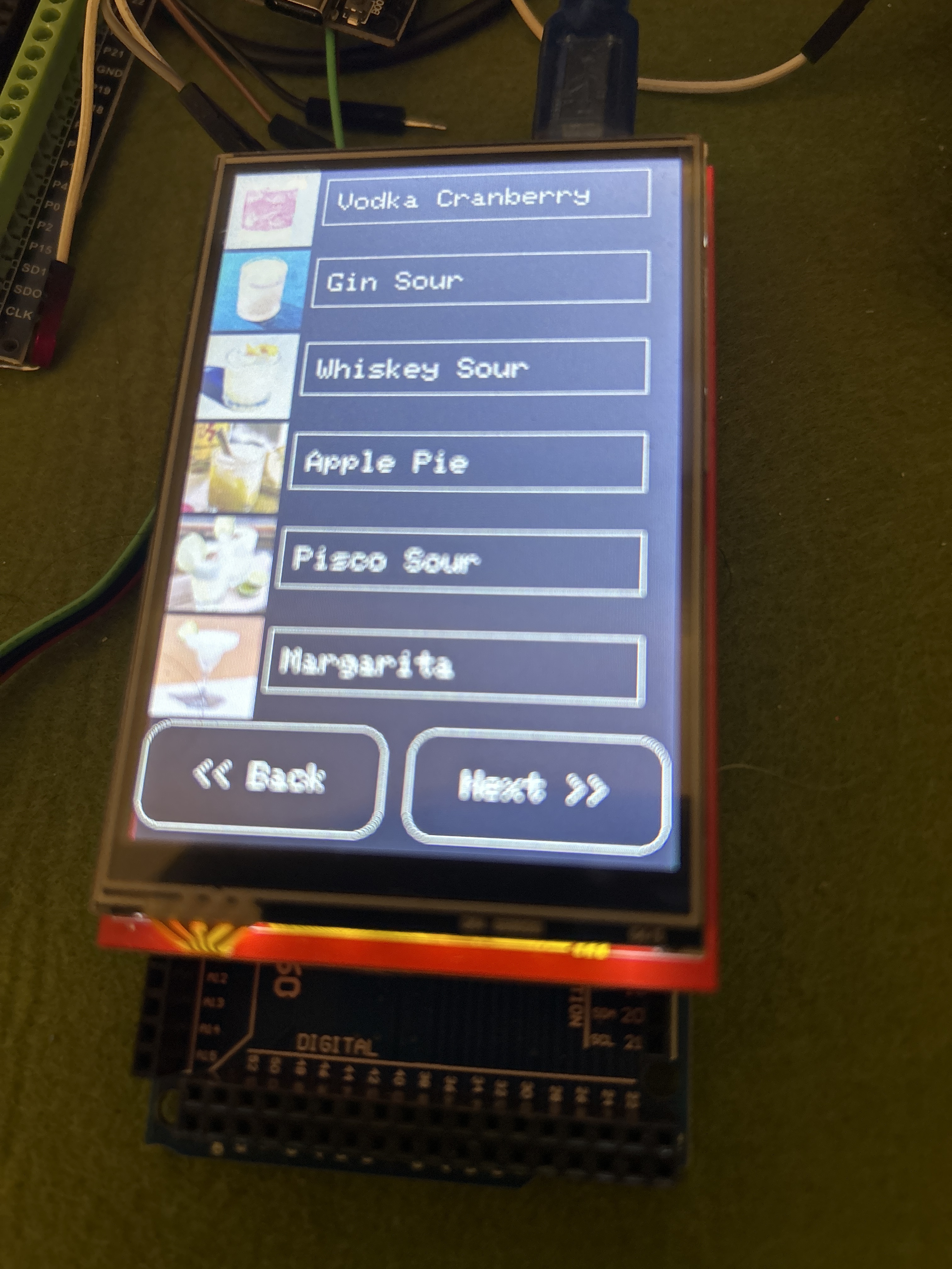

Can you see why the code might not be working with multiple menus
I use the SD card, so I would load everything onto it. Otherwise to add or change the menu, you need to recompile and upload the code. Just my opinion.
You are not separating the pages in loop. I'd try something like this:

can you give me an example of how that might fit into my code. I am not good enough to know where I would put that?
That is it.
Separate your menu displays into functions.
Separate your button checks into functions.
Call them depending on what the current menu sets new_page value.
so does that mean I no longer display them as void menu1()
I just made up function names. You can call them whatever you want. Dealer's choice here.

you mean like this
void menu1()
   int x = 0, y, w = 128, h = 64;
   y=0;
    tft.setAddrWindow(x, y, x + 64 - 1, y + 64 - 1);
    tft.pushColors((const uint8_t*)VodkaSprite, 64 * 64, 1, false);
   y=68;
    tft.pushColors((const uint8_t*)BlueLagoon, 64 * 64, 1, false);
   y=136;
    tft.pushColors((const uint8_t*)Cosmopolitan, 64 * 64, 1, false);
   y=204;
    tft.pushColors((const uint8_t*)LemonDrop, 64 * 64, 1, false);
   y=272;
    tft.pushColors((const uint8_t*)BlueMoon, 64 * 64, 1, false);
   y=340;
    tft.pushColors((const uint8_t*)BlueGinMoon, 64 * 64, 1, false);
      tft.setTextSize(2);
      tft.setTextColor(WHITE);
      tft.fillRect(70, 7, 230, 40, BLACK);
      tft.drawRect(70, 7, 230, 40, WHITE);
      tft.setCursor(80, 20);
      tft.println("Vodka Sprite");
      tft.fillRect(70, 75, 230, 40, BLACK);
      tft.drawRect(70, 75, 230, 40, WHITE);
      tft.setCursor(80, 88);
      tft.println("Blue Lagoon");
      tft.fillRect(70, 143, 230, 40, BLACK);
      tft.drawRect(70, 143, 230, 40, WHITE);
      tft.setCursor(80, 156);
      tft.println("Cosmopolitan");
      tft.fillRect(70, 211, 230, 40, BLACK);
      tft.drawRect(70, 211, 230, 40, WHITE);
      tft.setCursor(80, 224);
      tft.println("Lemon Drop");
      tft.fillRect(70, 279, 230, 40, BLACK);
      tft.drawRect(70, 279, 230, 40, WHITE);
      tft.setCursor(80, 292);
      tft.println("Blue Moon");
      tft.fillRect(70, 347, 230, 40, BLACK);
      tft.drawRect(70, 347, 230, 40, WHITE);
      tft.setCursor(80, 360);
      tft.println("Blue Gin Moon");
Void buttons1()
    next_btn.initButton(&tft, 240, 440, 150, 64, WHITE, BLACK, WHITE, "Next >>", 2);
    back_btn.initButton(&tft,75,440, 150, 64, WHITE, BLACK, WHITE, "<< Back", 2);
    vs_btn.initButton(&tft, 190, 30, 250, 40, BLACK, BLACK, BLACK, "", 2);
    bl_btn.initButton(&tft, 190, 98, 250, 40, BLACK, BLACK, BLACK, "", 2);
    co_btn.initButton(&tft, 190, 166, 250, 40, BLACK, BLACK, BLACK, "", 2);
    ld_btn.initButton(&tft, 190, 234, 250, 40, BLACK, BLACK, BLACK, "", 2);
    bm_btn.initButton(&tft, 190, 302, 250, 40, BLACK, BLACK, BLACK, "", 2);
   bgm_btn.initButton(&tft, 190, 370, 250, 40, BLACK, BLACK, BLACK, "", 2);
    next_btn.drawButton(false);
    back_btn.drawButton(false);
    vs_btn.drawButton(false);
    bl_btn.drawButton(false);
    co_btn.drawButton(false);
    ld_btn.drawButton(false);
    bm_btn.drawButton(false);
    bgm_btn.drawButton(false);
what do I do with this?

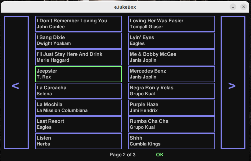

I think your project is beyond an Arduino. I have a Python program running on an RPI3 that would be right up your alley. It currently plays my mp3s I call eJukeBox (shows my age). I can access it from any computer that runs Python on my localnet. It could just as easily mix drinks.
Wow, that would be awesome, so let's do that after, I at least need to complete this task, cos I think that's a whole other game. I must try to at least complete this task for my own sanity :slight_smile:
