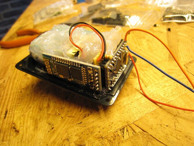

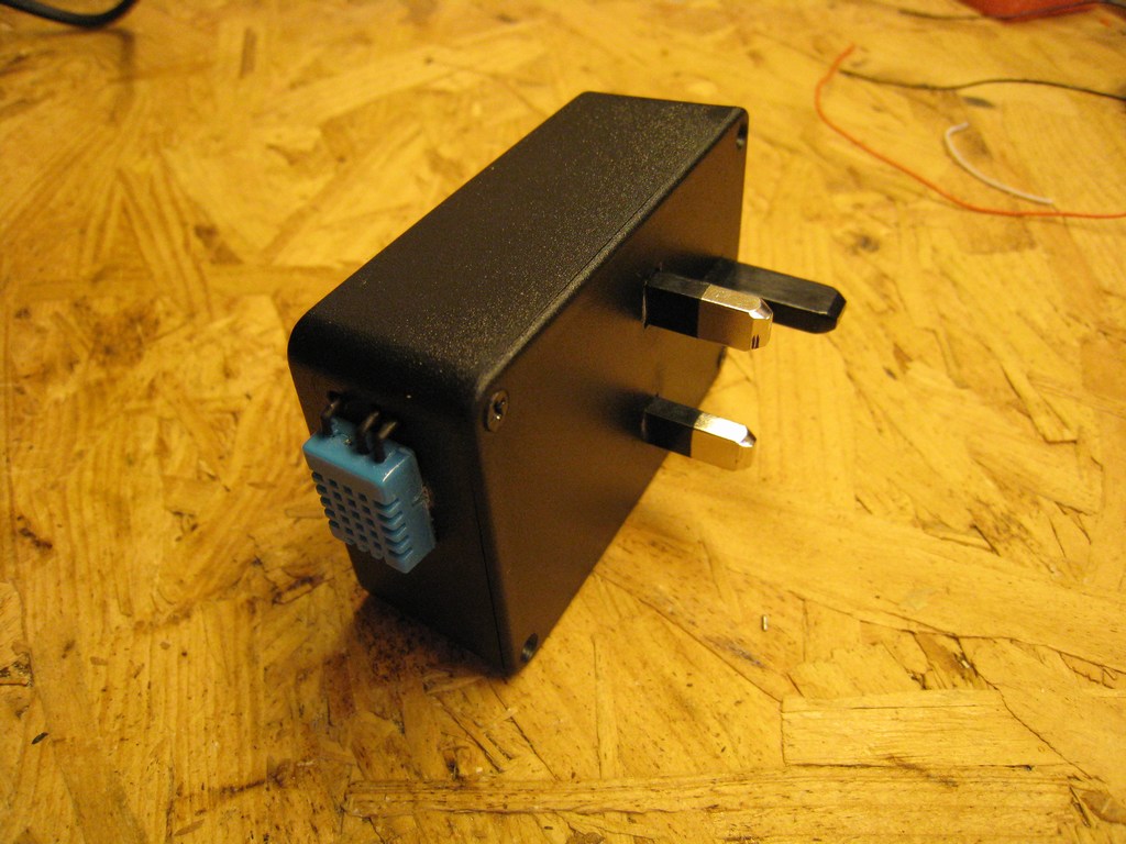

I'm also currently working on my own home automation project. I'm using the Arduino Mini (Pro) because of its tiny size. They are quite cheap too, so I will have many of them around the house; one per device I want to control. (I find this better than running long cables from a single Arduino to all devices around the house).
Then I'm using either Bluetooth modules or RF1100-232 433MHz RF wireless modules to send and receive serial commands to/from the Arduinos. (I'm actually now moving away from Bluetooth as it is far more unreliable than the RF modules and has shorter range).
Then I have written a Windows application in C# that controls all these devices and keeps current values for each device in memory that can be get and set by a web application (that my friend develops) over IP.
Currently I have temperature and humidity sensors and a 10W RGB LED that I can control remotely. Next thing will be an Arduino controlled relay that will fit inside a ceiling rose that allows me to switch the lamp on and off remotely.
This brings me to what I see as the biggest issue with this project... Power supplies. Since all these devices connect to 240V mains (I don't want to re-cable the whole house....), each of these devices needs its own little power supply. I'm using the smallest I could find (5V "USB chargers") but still, the PSU always takes up the most space in these devices and limits how small they can be made...
I have exactly the same problem with my projects. Even with 110V, it's hard to find power small enough to keep the project tiny. I have also been using the USB wall warts, but I take them apart and use just the power supply and throw the plastic shell away. Helps some, but not as small as I like.
Yes, I did the same. Removed the shell and put it in a slightly bigger case that houses the PSU, an Arduino Mini and a Bluetooth module or RF1100-232 module. Then there is a DHT11 sensor glued to the outside. The whole thing plugs into a power socket just like a wall PSU. 2 pictures attached. All that hot melt glue is mostly for safety. I didn't want any mains power exposed.... :wink:
What we would need is a very small switch mode PSU, say, the size of a small relay. Does something like this exist?
I haven't found one yet. I'm still looking though. Nice job on the module, and I would have done something similar to secure the power.
