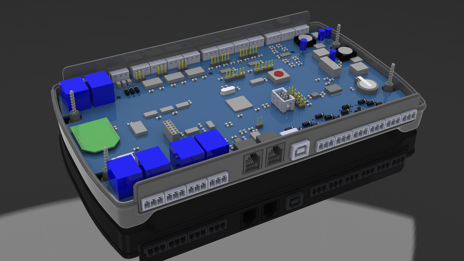

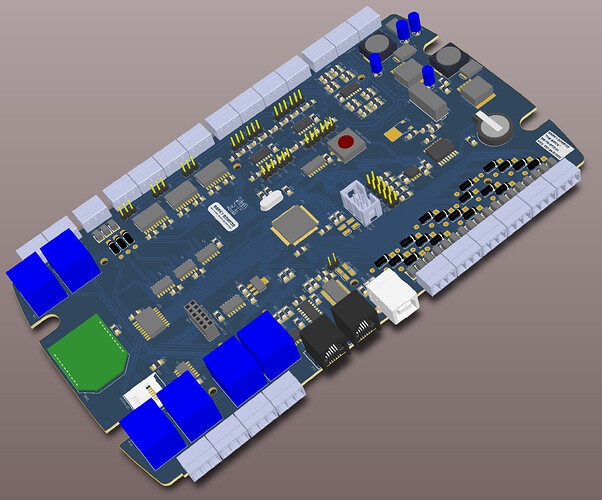

Here is a picture of the PCB:
Here is a rendered picture of the PCB is the case, top removed:
Here is a rendered picture of the case closed up, back view:
I am just finalising it at the moment and hope to get the first prototypes ordered this week.

Great-looking board Wanago, talk about a Mega on steroids :)
Any price guesstimates yet? I'm guessing it won't be cheap but then it's a lot more "industrial strength".
Rob
That is quite an ambitious board. Of the features, I would only have liked to see 12 bit DAC or even 10 bit DAC over the 8 bit you listed.
Good luck with the project.
Lefty
