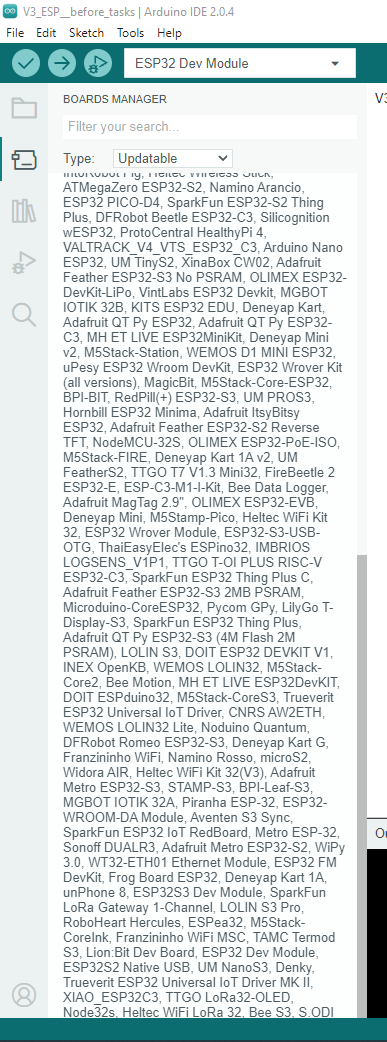

I also have the problem, that the split screen doesn't close, even if I restart the IDE. There is no pattern in the replace field. How can I close this second screen?

By the way, not necessarily related to the problem you experienced, but I notice from your screenshot that you are using a significantly outdated version of Arduino IDE (2.0.4). Unless you have some specific reason for using that version, I highly recommend you to update to the latest version (2.2.1 at the time of writing). There has been a tremendous amount of development work since the 2.0.4 release of Arduino IDE you are using, including important bug fixes and enhancements.
Thank you. I'll update the IDE right now.
Another update is not done yet, that I also wanted to run.
The reason that I didn't update it was that I cannot select the button in the board manager because it is so much text in the IDE that the button is not available. I want to do the update manually, because I don't want to update all the libraries. (I use the function getFormattedDate() in other projects. This function is lost if I do an automatic update.

I remember some bugs like that:
opened 06:20AM - 03 Sep 22 UTC
closed 08:20AM - 05 Sep 22 UTC
conclusion: resolved
topic: code
type: imperfection
### Describe the problem
The IDE's **Library Manager** and **Boards Manager**… list the libraries and boards platforms that are available.
Since there are >5000 libraries, and even the primary package index alone contains a significant number of boards platforms, the length of the list will often exceed the vertical display area of the view, meaning the user will scroll down to reach items lower on the list.
When the mouse pointer is hovered over one of the list items, a version menu and "**INSTALL**" button are added at the bottom of the item.
🐛 The interface elements are not accessible for the last item on the list when the list height is equal to or greater than the vertical dimensions of the view.

They were fixed some versions back. Please let us know if you still experience the problem after updating the IDE to 2.2.1
